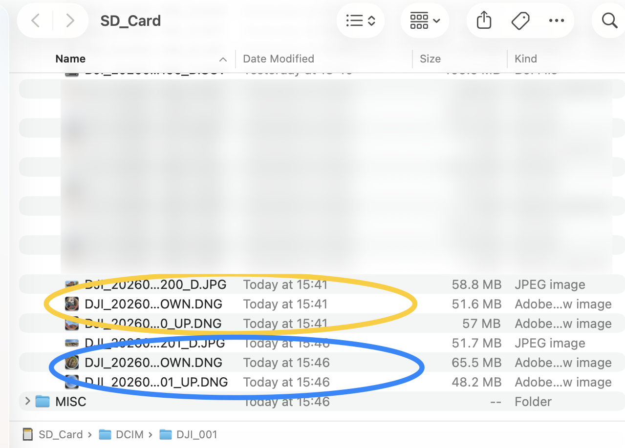

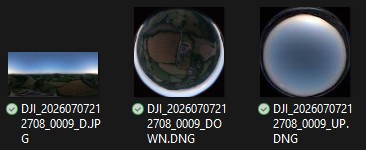

Yep definitely does jpeg and raw together.

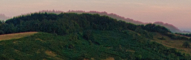

Comparison between drone created jpg and processed raw using panocool. Both tweaked slightly with Luminar.
Jpeg;
Raw:
I prefer the jpg straight off the drone.
There is definite misalignment in this one using panocool.

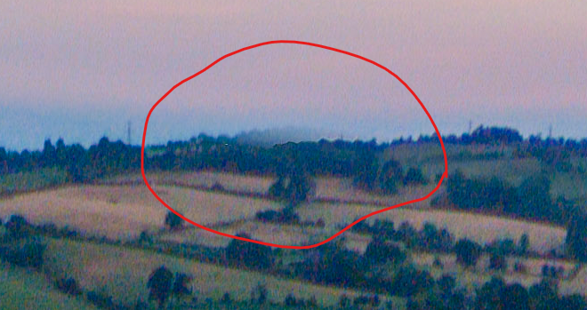

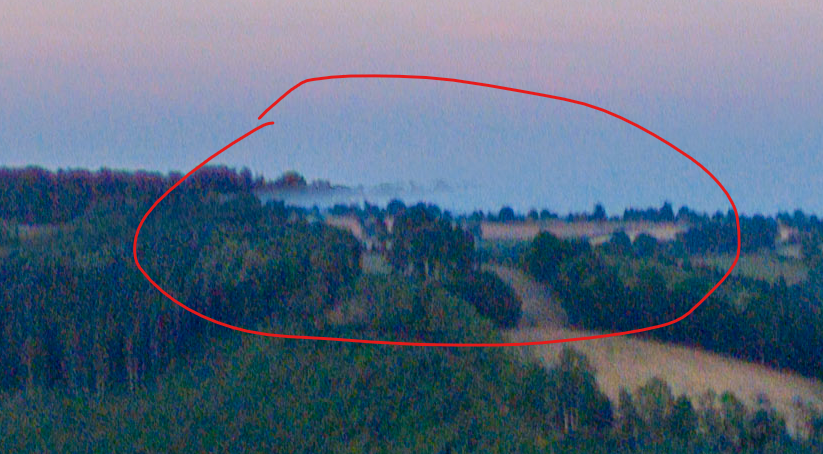

Can I find an error? Yes .. just two.
Obviously any errors are going to be around the horizon .. since that’s where the only stitch is .. but the following is the result of ..

The errors?
Chances are, in this image, they’d not be noticed by anyone other then the most scrutinising .. and almost acceptable. Seen plenty worse ones. ![]()
Would be interesting to test with some with clean lines crossing the horizon.

Dave if you want another
DJI_20260711175827_0204_DOWN.DNG (53.0 MB)
DJI_20260711175827_0204_UP.DNG (47.5 MB)
To compare with the onboard stitch
I’m not entirely sure they are stitching errors. They might actually be correct and it was just like a haze.
Yes feel free to fire them off if it helps make the software work better. Is thete anyway I could get the beta version if I purchase a license?
I’ve looked at the original .dng and .. eventually found the location of those points. They are errors, and are positioned in a mirrored location on the originals.
I can also send them the locations of the poor stitching.

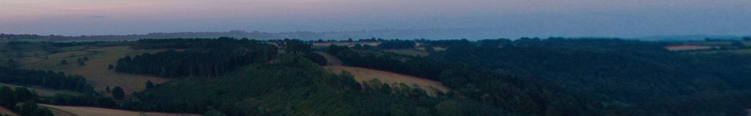

Incidentally - one nice thing about Panoee is it’s pretty quick .. even on my dinosaur of a laptop ..
Longer for the 26+ images of other DJI models, obviously.
Didn’t adjust in LR for this one - exposure seemed pretty OK.
Not perfect stitching, as yet ..
Thanks for the Panovolo beta, it seems to work very well. Image is a bit noisy but that’s my fault, need to work more on camera settings.
A quick whizz around the horizon on that one and I see no problems.
