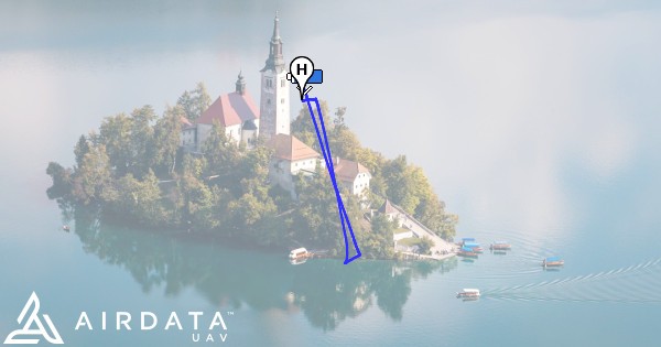

@SJPhotography, it would be really useful if you could share the Airdata logs for this issue, it’ll help people provide you with a more detailed answer based on what actually happened.
If you’re not familiar with Airdata it’s an independent platform that allows you to aggregate your flight records and it also allows you to share logs with other people.
Here’s a guide on how to upload your flight logs to their web site / app:
Setting up Direct DJI Sync
Once your logs are visible in Airdata you can use this guide to share the log(s) in question:
Once you’ve created the share on the Airdata web site simply reply here and paste the URL, someone will then take a closer look for you.

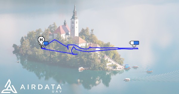

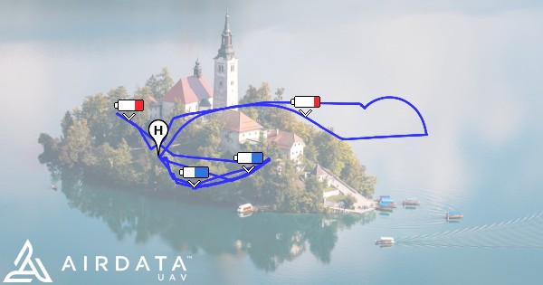

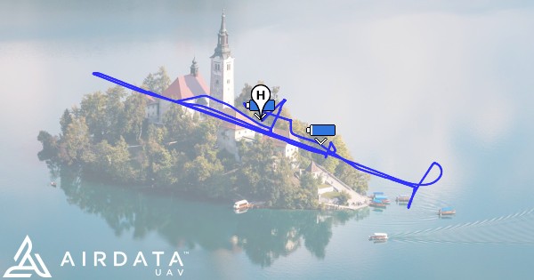

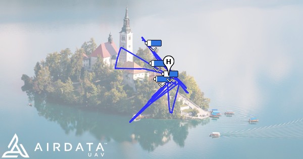

Had a look and your in sports mode and even when there is no stick movement I cant see anything on the HD Flight player that would suggest its drifting - just a lot of stick movement — Dec 29th, 2025 12:29PM | General / Notifications | DJI Fly log 1.19.4 | United Kingdom | AirData UAV

just had another look and yeah the wind was a bit higher - the others are like 5ms but that one was 7.2ms so maybe - you really need to have it hover in front of you and leave the controller for a few mins to see if it moves to know for sure.

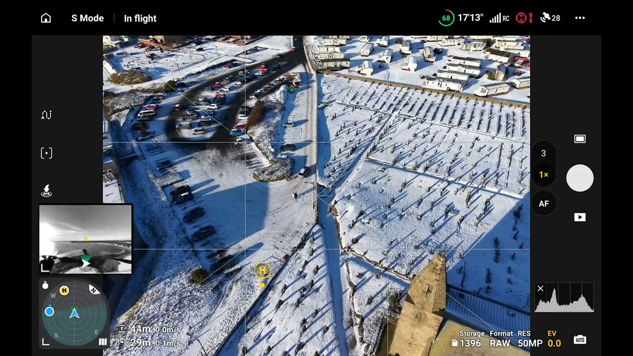

So had the drone out today to test it again, I have attached a video of what it is doing if you skip through you will see i am trying to fly along the wall with straight movement and this is how it drifts, i will attach the flight logs as well (last 5 mins of the flight log is the part of which this screen recording is from), I noticed it wasn’t initially doing it for the first few mins of the flight and then seemed to start out of no where its very weird.

The first time you fly the wall fine - I see little to no drift with the camera pointing outwards - when you point it downwards there is “drift” but I don’t think it is drifting as such its more to do with the orientation of the drone and its direction of flight in ref to the wall and the camera
Basically you need a straight line down the middle of the drone and to fly that line looking above the drone to know for sure - but if you hover it does it move off point ? if not then its not drifting and its just the direction of flight v the direction of the gimbal - at least thats my view on this.
If the camera is not in perfect alignment to the body of the drone and the drone is not in perfect alignment to the straight line your flying it will look like its drifting off center point as the drone is not flying the direction you think it should be going. - well thats my theory at least.

I also notice you like to fly in sports mode - maybe try it in normal or better still cini mode so that its not flying at like 50km/hr - at speed that small little bit off will get bigger quicker.
Looking at the logs as you did it a few times its hard to see the lines v the flight but if its off its like 1deg off its so small its hard to tell.
We also need to remember that the drone is actually flying through a moving fluid (the atmosphere). If it were a boat in water, going across a current, it would be more obvious and we’d probably just accept it. You’d need to perform these experiments on a windless day, flying along a straight line (e.g. taut string) that was perfectly aligned with the longitudinal axis of the aircraft.

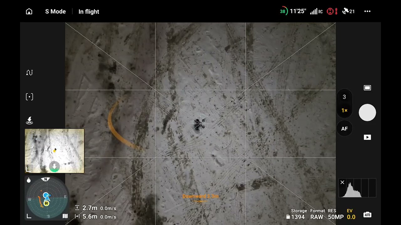

So went out tonight to photograph the last night of the Alnwick garden lights :rofl: and after what you said I decided to do a hover test and It seems good to me, What do you think?
Should have really done it int he day light but even so it seems pretty steady I found the most shaded area I could winds maybe 10-15mph gusts where I was standing. the bit of missing snow was perfect to centre it haha, I did put it in sport for this just to quickly disable the obstacle avoidance as it was trying to move away from the wall haha.
Please let me know what you think, Can’t thank yous enough for helping me :grinning_face:
All appears to me to be working well and behaving as it should :slightly_smiling_face:

There is nothing wrong with your drone but if you still feel there is then for peace of mind I would do a full calibration of the imu, compass, gimbal and controller
Also bear in mind the gps accuracy and tha amount of sats before and during the flight
