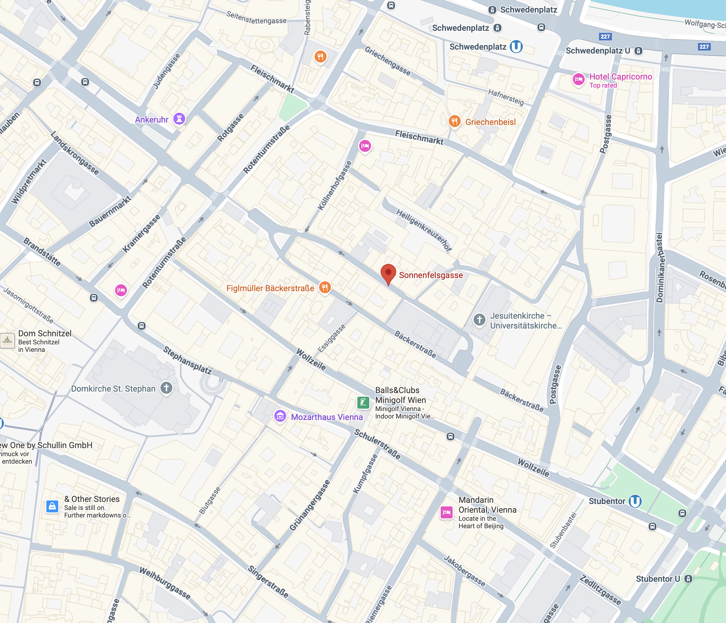

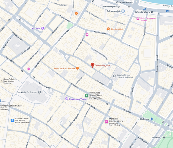

Incidentally, where are you staying? This is where we stayed. Couldn’t be more central really.
Is it a pleasure trip or business?
In Vienna, very near the Hauptbahnhof train station. We went in 2024 and were there for 4 hours between trains from Czech to Hungary. Pleasure - family holiday travelling through 3 countries.
