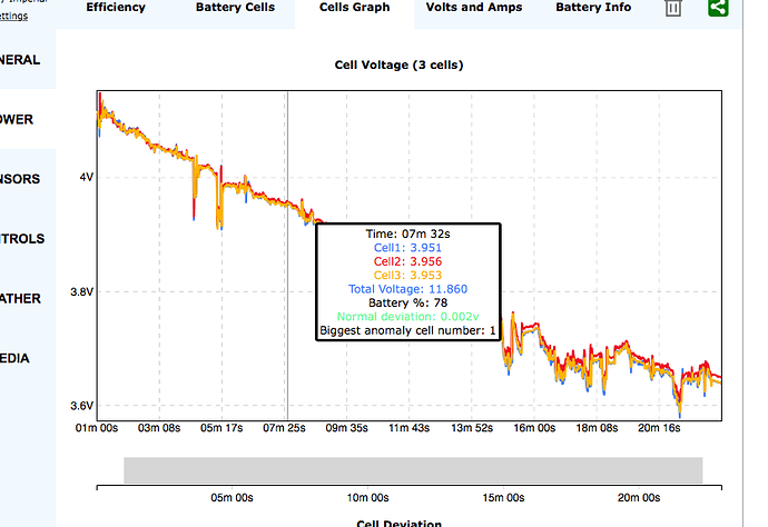

Battery life seems good.
Autel quote 40mins but as per DJI thatās gonna be in laboratory conditions eh.
I flew a single battery for 23 minutes and landed with 30% still left.
If someone can work out how much time I had left from that, please let me know. My brain has given up the ghost for today.
Iād need to do some proper battery tests though, this flight was a crazy mixture of flight manoeuvres, hovering while changing settings, testing āLudicrous Modeā (which makes DJIs Sports Mode sound tame
) etc so perhaps donāt pay too much attention to that battery life stat just yet.
The batteries have the same self-discharge functionality as the DJI LiPos too, also user definable in the app up to a maximum of ten days. Iām not sure if pressing the button to check the battery level resets the counter like it does on DJI, will let you know.

AirData UAV.
For some reason, AirData canāt see the battery serial numbers so it thinks I only have one battery
Yet strangely, it can see all of the individual cells in the battery, and their deviation.
Weird that it canāt then see the serial numbers eh?
