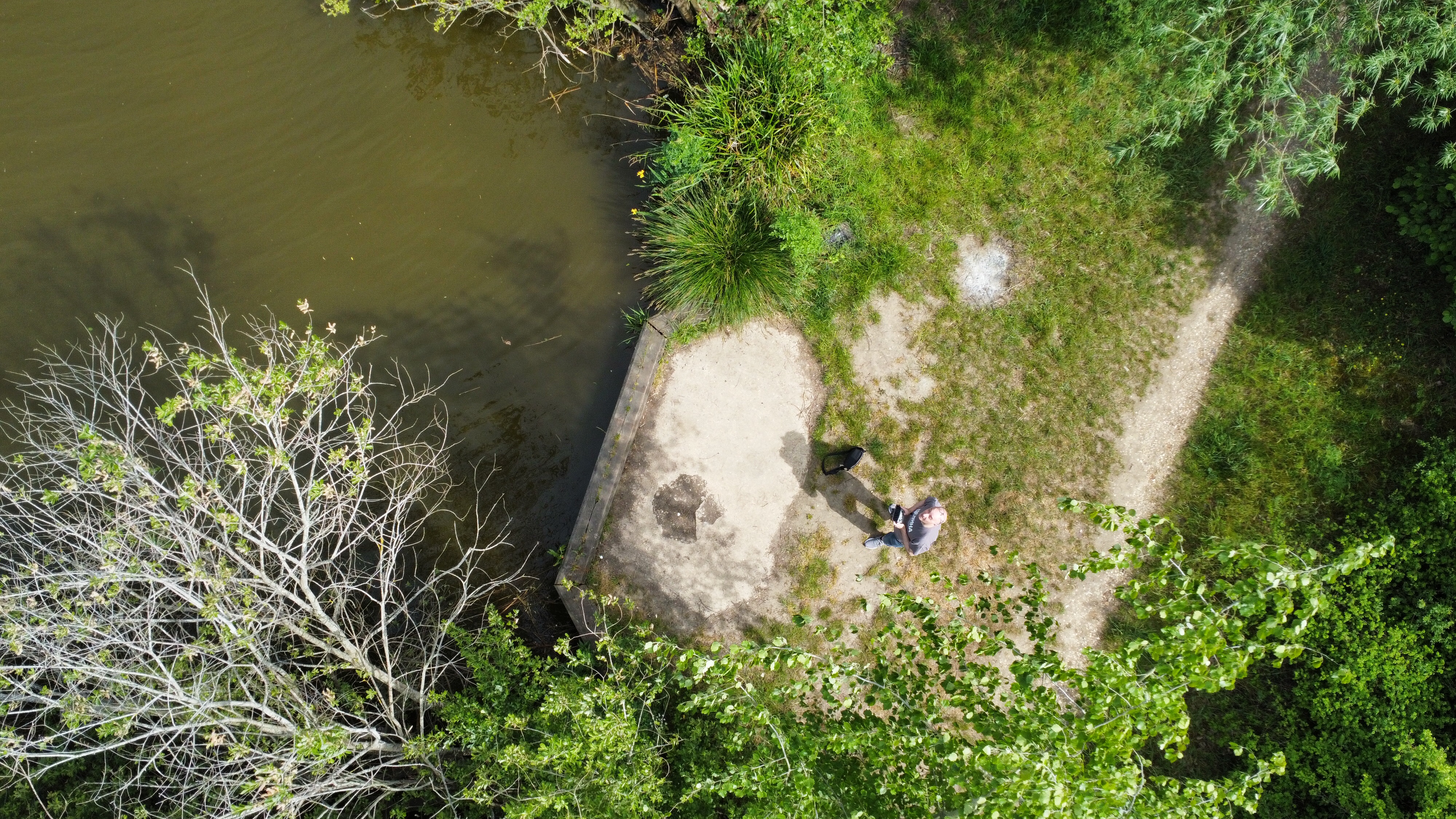

I was fairly bored this afternoon and took the opportunity to go out and practice flying by the Jubilee River (Windsor Flood Relief). For want of anything better to do I decided to see how high I could go and how close to the river I could get. Just getting everything ready and drone about a foot above the water and I took my eye off it for a second to look at iPad and next thing I knew sounds of props changed and when I looked up it was in the river. I still managed to take it up to 390 feet and back to a foot above the surface. You can see at beginning it in the water and then as it goes up all the water dripping from it. I think I shall call this a ‘learning opportunity’ in the words of Pres Bush!!!
