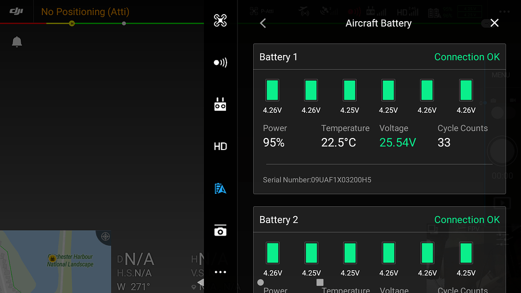

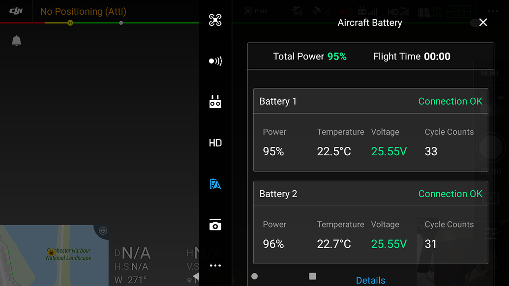

What I can do, if you or anyone else is interested, is to charge each battery, put it in an Inspire chassis and screenshot the battery information shown in DJI GO4. It will look something like this:
(TB50s in a Matrice 200 series)

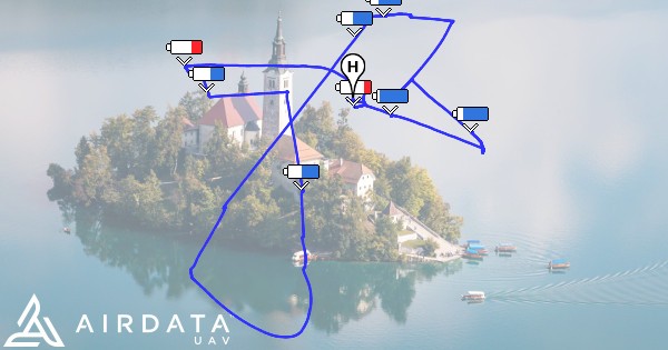

If really pushed I could fly the battery and download the battery info from Airdata but my plan would have to be upgraded - I am already at the limit with batteries from my other aircraft - and that would cost me serious money, an extra $100 per year :frowning: .
This is battery info from an Inspire 2 flight. Note the deviation in one cell althouygh Airdata is happy with the overall health:
