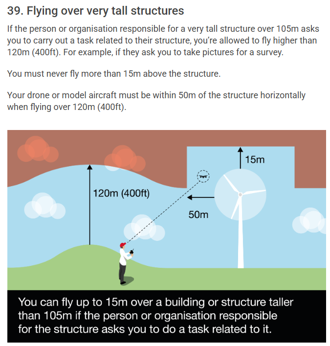

Hopefully this will answer it for you
There are still a few questions here I am sure -
If a person or org askes you to fly over THIER structure ( so only the owner can give you permission it would seem from the wording ) you could do so and its not a given for all tall structures
And the other would be that your drone would not be restricted to fly over 120m / 400f from its take off point like many of the mini drones are now.

Sorry if I have got this wrong but the drone code Jan 2026 states 120m or 400ft. It does not stipulate any difference regarding class. Now 105m + 15m above max 120m
From drone code jan 2026
Special Permissions:
For flying above 400ft in other circumstances, you need specific CAA permission.
CAA drone code. Scroll down to “Less common flying (points 37 to 39)
Interesting point at 39

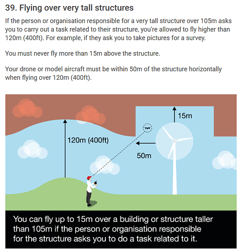

Ah,as some have pointed out, this seems to be the relevant paragraph;
So, my interpretation, if the building is 200m you can fly 215m vertically and within 50m horizonatally from said building.
You can fly up to 15m over a building or structure taller than 105m if the person or organisation responsible for the structure asks you to do a task related to it
Not quite true, the hight limit is taken from the ground below the drone not your take off point. If i take off from a hill that is 100m high and 200m away it doesn’t mean i can fly 220m above the ground next to the building.
