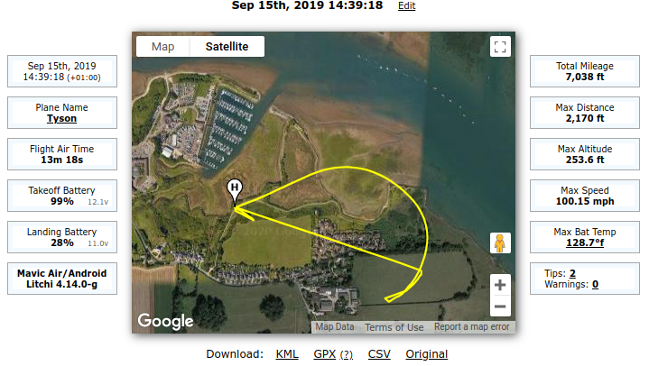

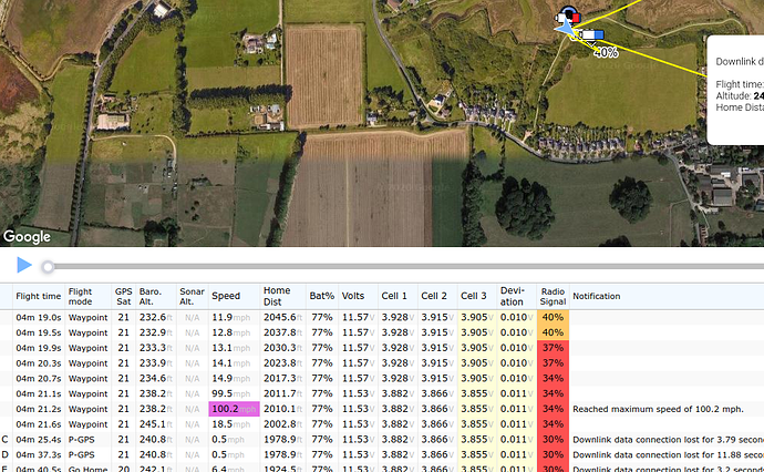

Wowser 14mph - 100mph -18mph in under a second

I’d be more interested as to how you manage to mod the motors/props to provide >40 Newtons of horizontal force to provide the acceleration of 95 m/s/s … without much height increase.
Even the space shuttle maxed out at 30 m/s/s.
95 m/s/s is close to 10G.
I think this one needs to be attributed to some onboard computational quirk.
If not - NASA will give you a highly paid job. :wink:
:rofl: :rofl: :rofl:
Err, tweeked the max tilt angle from 35 to 90 degrees.
Used a 110volt battery charger on 240 volt circuit.
As I have discussed elsewhere - an error and a several second loss of control with the aircraft rotating wildly - caused by the nearby artillery base on Thorney Island who were testing anti-drone measures at the time deciding to have a little fun with a civilian target.
