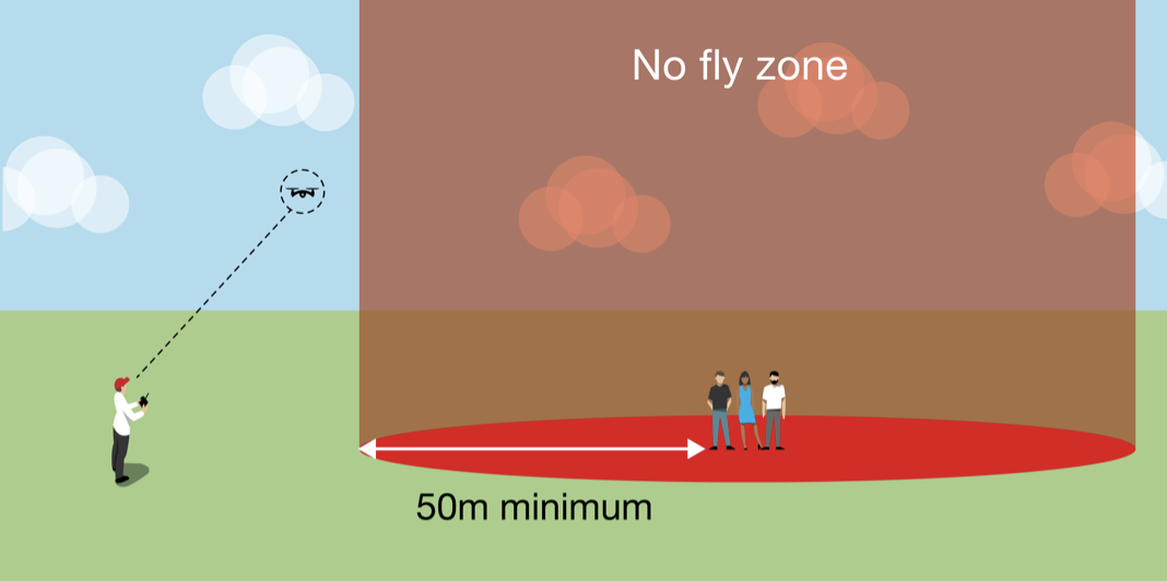

Your mini 2 is a legacy drone in the A1 Subcategory so that’s:
Fly over uninvolved people, but not over crowds
Your Mavic 3 and Mavic 3E are A2 Transitional so that’s:
  • With the A2 CofC = A2 Subcategory:
No closer than 50m horizontally from uninvolved persons
  • Without the A2 CofC = A3 Subcategory:
No uninvolved people present within the area of flight. Maintain 50m separation from any uninvolved people

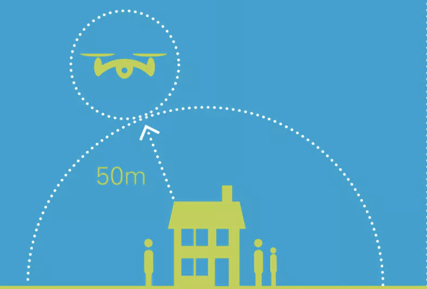

If you get your GVC you can apply for Operational Authorisation to fly in the Specific Category. Under the standard risk assessment, that gives you almost exactly the same restrictions as having the A2 CofC with one notable exception.
Under the the Open A2 subcategory the 50m minimum distance is horizontal so it’s basically a column you can’t enter.
Under the Specific category that 50m minimum becomes a bubble, so you can (so long as you’re 50m up) fly over uninvolved people (still not crowds though).
