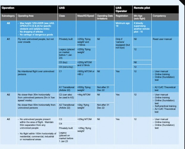

Thanks, that’s mostly clear, but the Mavic 3 Pro is >900g and is C2 under EASA. The rest of the Mavic 3 range is C1 as <900g I believe. So the Pro needs A2 C of C equivalent in Europe as you say, and probably will need our A2 C of C here after Jan 26.
@BingBong This is a screenshot, Bruce, of the old version 1 page guide out of the CAP 2012, which Sean believed to be similar (defo not guaranteed) to what will happen next year.
Apologies .. yes you’re right, the pro is C2 under EASA, so the additional cert would apply.

Looking at @D0c.Col 's screen shot, “Privately Built” only appears in A3 which means my 54g tiny whoop is lumped into the same category as a 24.99kg behemoth and can’t be flown within 150m of any sort of building. Have I got that right? :laughing:
Cheers Colin, according to that, flying A3 doesn’t require A2 C of C for C2 drones, which would be good. A2 C of C only required to reduce restricted distances as now.
Yes, it looks that way. They may come up with a scheme to get legacy drones sorted and maybe kits approved with the correct markings, but who knows!
