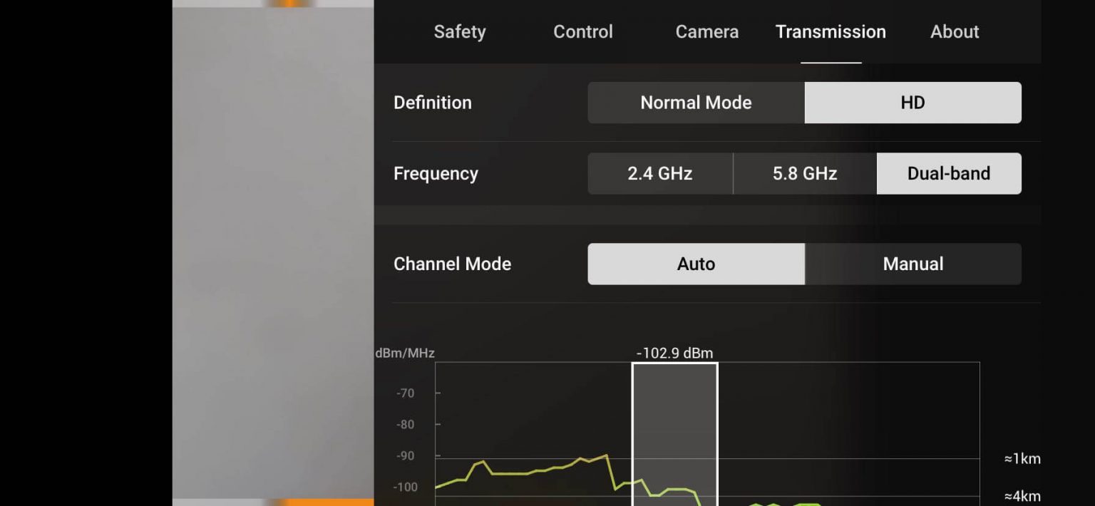

Also, the new controller supports two ways of transmitting video to the controller. “Normal Mode” and “HD”. Try it on normal mode, as it needs a lot less data.
