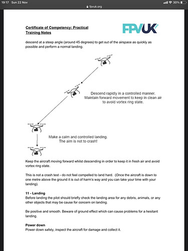

Rather than coming straight down, descend on a slope. When coming straight down you are descending into the very unstable air of your own prop wash. As @Nismo says the stiffer the prop the less forgiving it is in very turbulent air. This is why you very rarely see a helicopter descend straight down but rather sweeps around to the landing spot. If it makes a straight down descent it’s very slowly.

Such a manoeuvre might also come in handy elsewhere in your drone hobby too :wink:
Thanks for the reply guys I’ll give the sloped descent a go next time out see if it helps :+1:t2:
