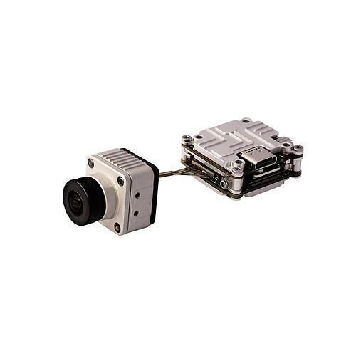

And all of this is beginning to pay off. Take the very recent release of upgraded HDZero cameras. Even the manufacturers of these cameras were sceptical about the success of HDZero capable cameras. So much so that Carl Zhou, the owner and developer of HDZero, had to use his own money to have the cameras manufactured. Runcam have now been forced to eat their own hat as every time a batch is offered for sale they have sold out in less than two minutes.

One thing I have noticed in the few flights I’ve now done with SB is that my goggle battery drains noticeably faster. I guess this makes sense as the battery is powering both the goggles and HD module. Its not a problem as I have 2 fatshark battery packs. As a comparison if I flew all 6 of my batteries on my analogue quad the fatshark battery would have 2 leds of power left. When I flew 5 batteries on SB I had 1 led of power left. Next time I will charge both fatshark batteries just incase :+1:t2:
As a side note my new HDZero micro cam has been shipped :ok_man: not sure how long it will take to get here but at least its on its way :grin:
Same with my DJI goggles running the digi adapter with rapid fire module. Battery drains a hell of a lot quicker.
Yeah they stink mate.
Yeah I guess it’s because they are powering 2 devices at once. Not a big problem though

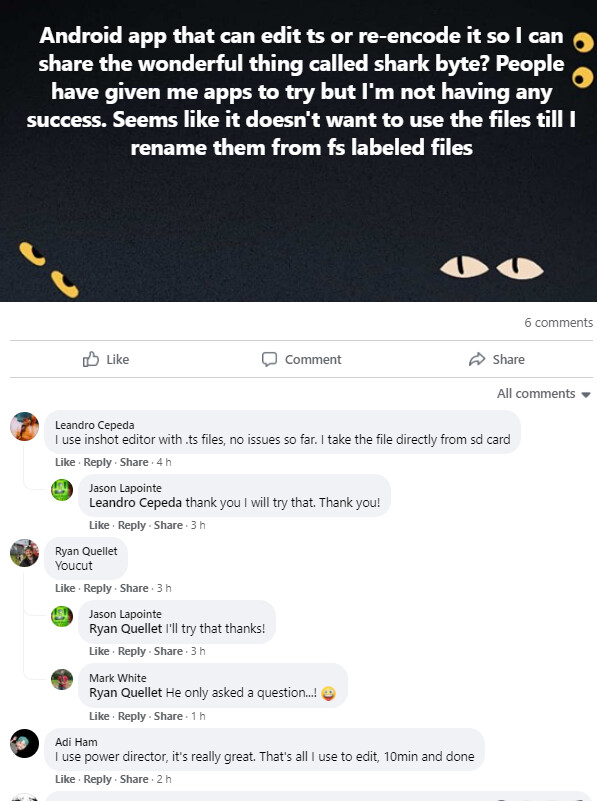

@SirGunner not sure if you have tried these?
Cheers mate I’ll take a look, I have got the premium version of Power Director and that doesn’t like .ts files lol
