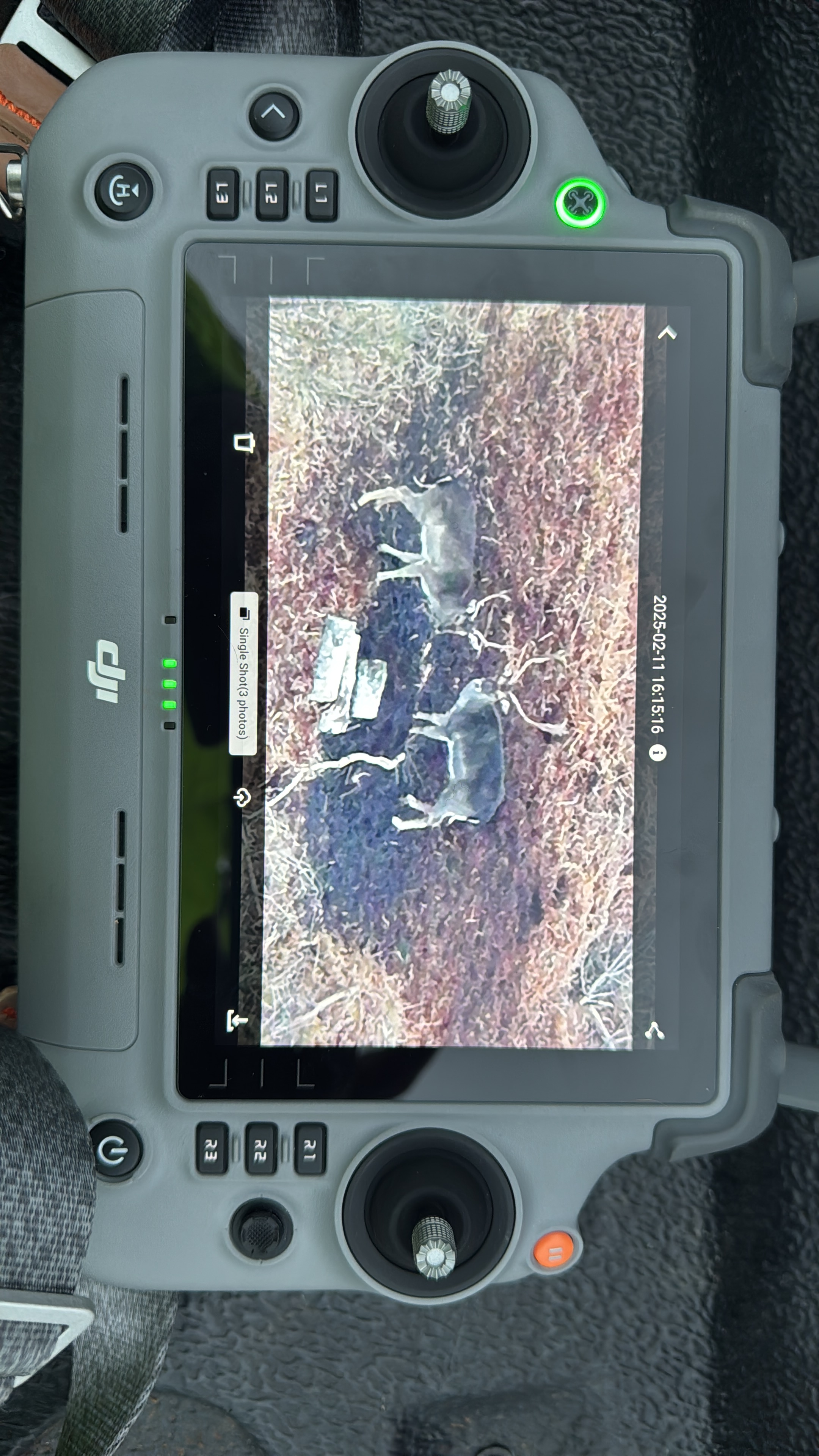

Hey everybody! I thought I’d drop into this thread as I’ve recently bought the Matrice 4T and must be one of the first commercial operators using it in the UK. I also operate an M30T and I almost didnt both upgrading to the Matrice 4 when I read the thermal wasnt better resolution (at least on paper) and the usual reviewers did what they ALWAYS do (and DJI) and totally ignore the thermal capabilities in their reviews… But I had an aging Mavic Enterprise 2 Advanced which was getting long in the tooth so I wanted a smaller bird for survey work (we do thermal deer surveys mostly all across the UK and abroad.)
So… whats it like? Its not perfect, there are some stupid design choices but these are fairly minor in the big picture. Its really light, made of the same plastic as the Mini series, but the flight time is vastly improved, in light wind conditions I’m reguarly getting 35 mins in the air. The thermal is the same resolution, but its FAR more sensitive, I’m detecting squirrels and birds and mice from over 100 meters away in the air. Its actually a bit TOO sensitive :-). The night scene mode is pretty decent! I can now survey into the twilight far longer than before. But having the NIR spot light. built in is the real game changer! I can now light up deer in pitch black night see what species they are from 100m above and zoom in on the tele lens. That was worth the upgrade.

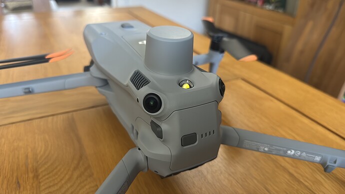

Bad points? Lack of any IP rating at all! Anoying for an enterprise drone! The RTK module lump on the top totally blocks the Nav LED light so when recording at night and the front LEDs go off for filming, you cant see the bloody thing! M30 has a NAV LED on top and bottom! Getting the SD card out is tricky as you need a childs fingers to get to it!
Aside from that though its a fab bit of kit! Pricey but for me and what I do its a game changer!

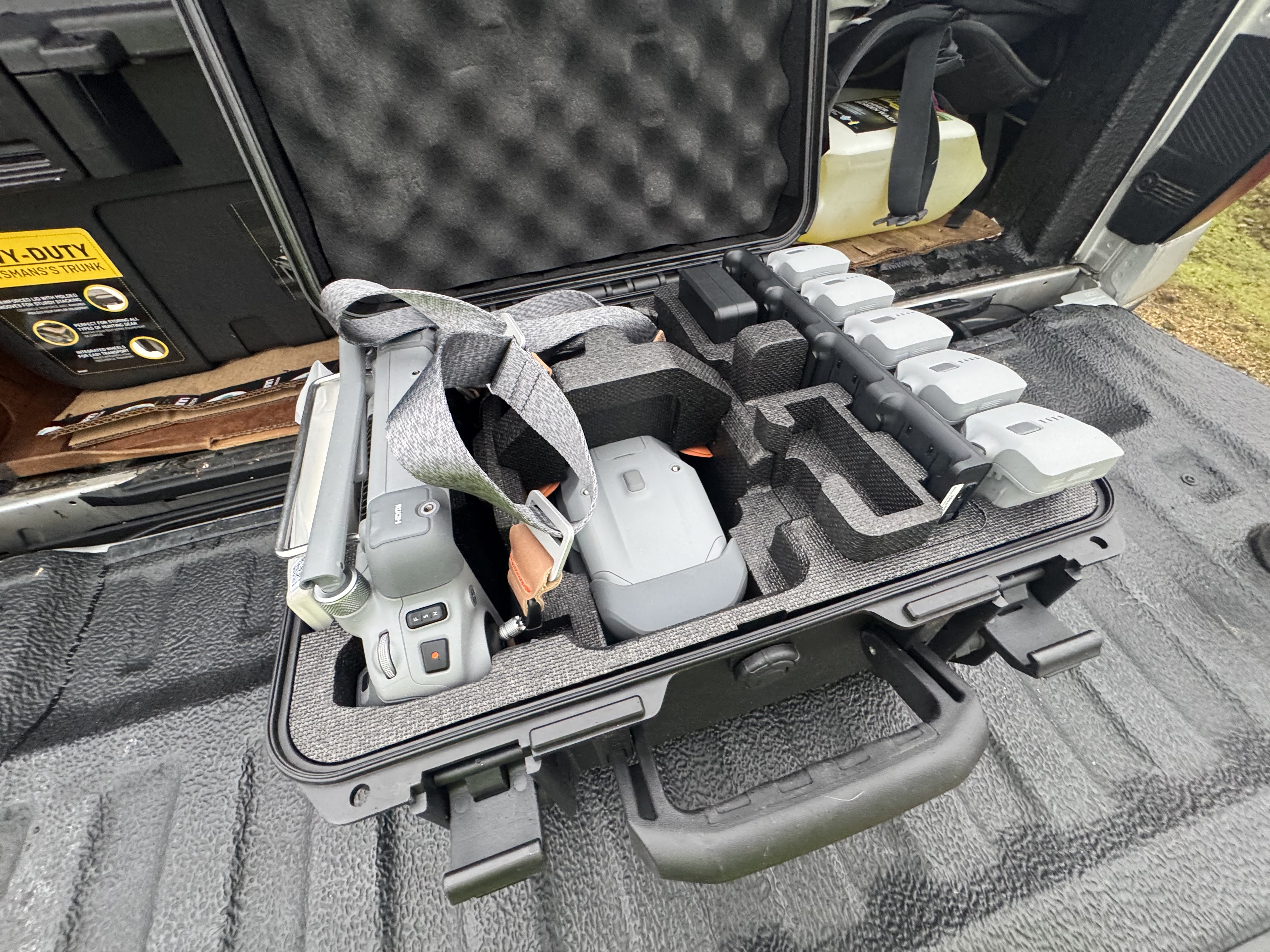

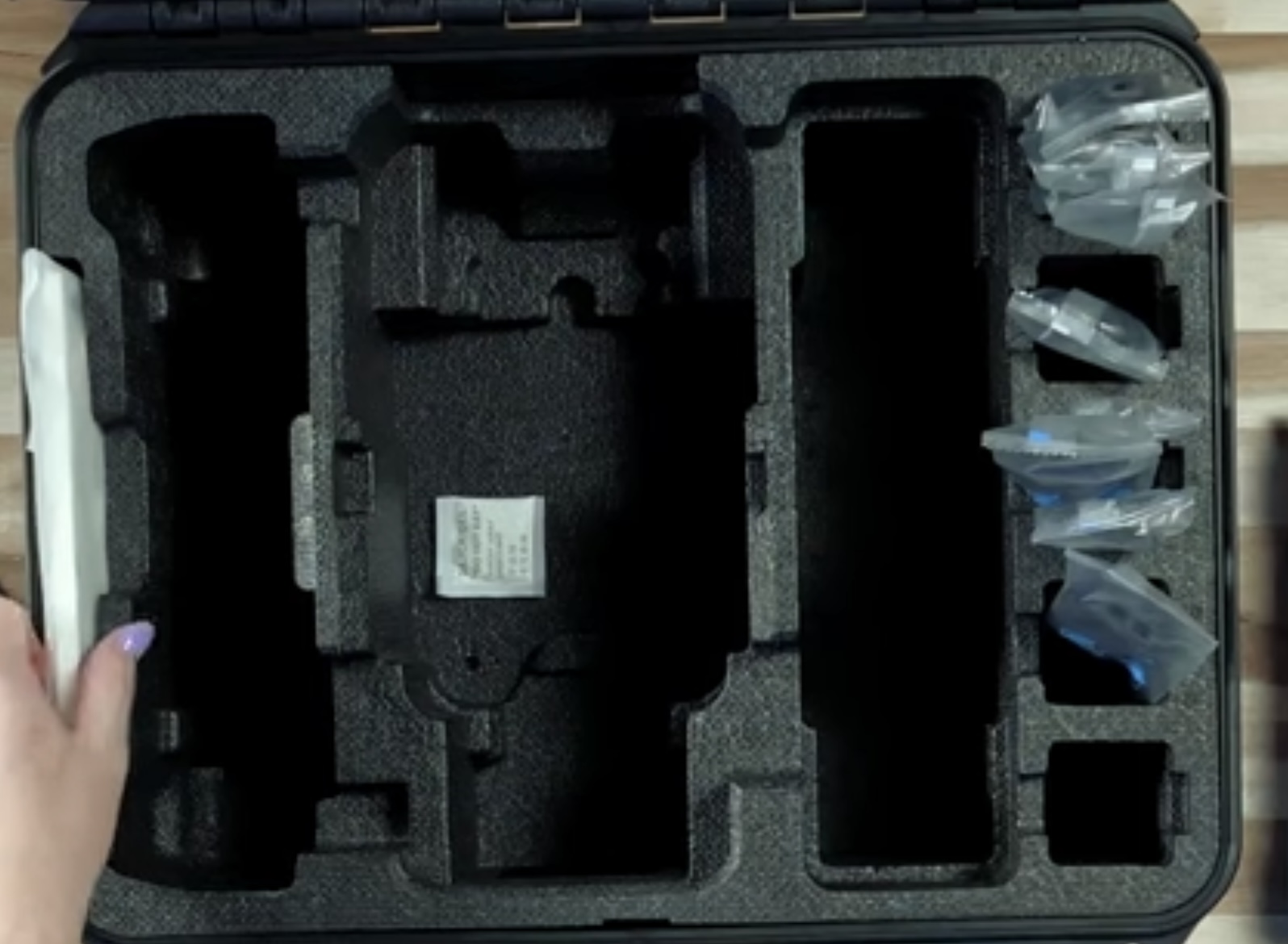

could someone kindly post a photo of the inside of a matrice 4 standard case.
does it have 4x battery slots / pockets or 5 plus 1x in the drone
I cannot seem to find a good image of the inside of the case.

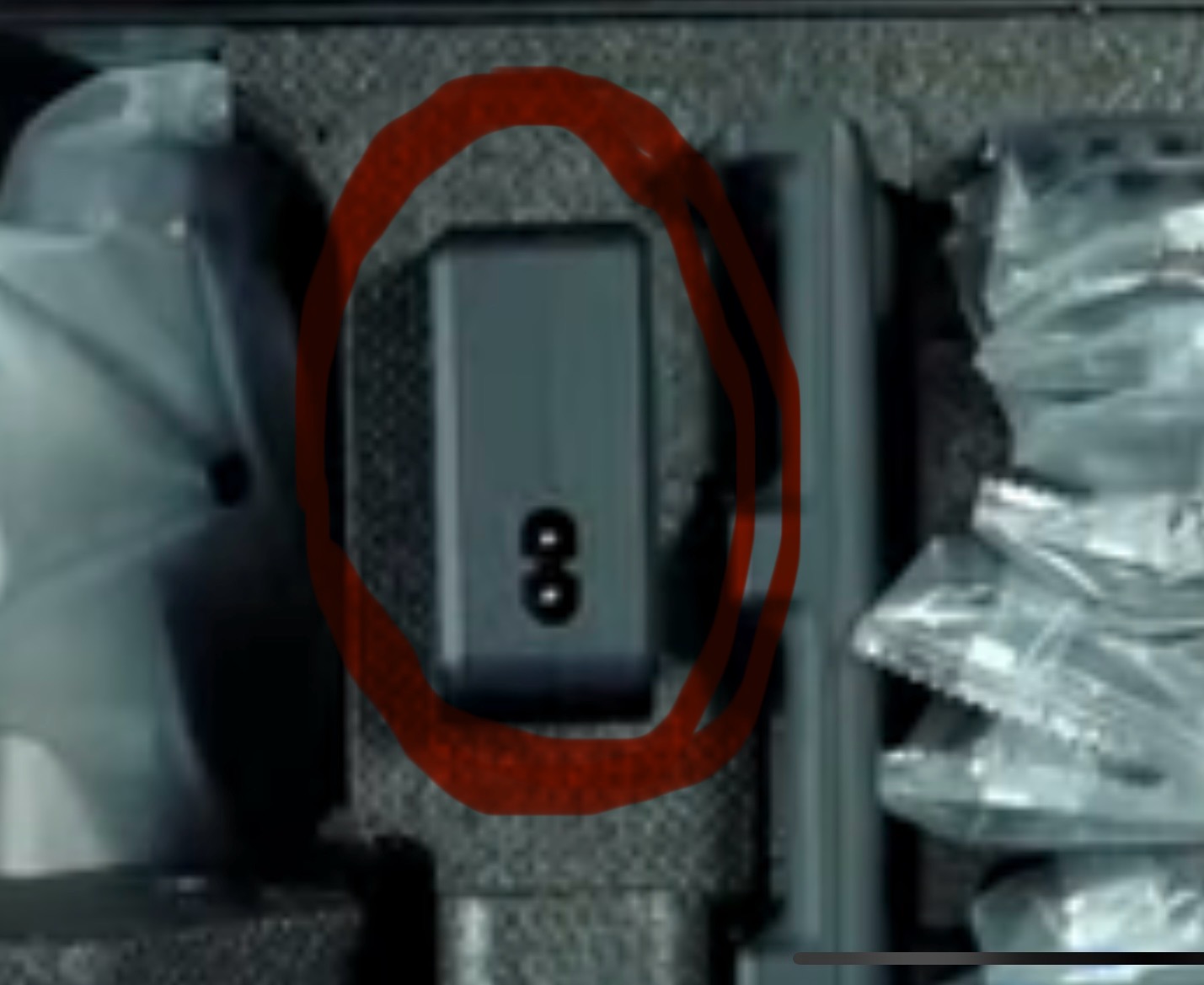

This might help, where the props are stored are battery storage etc etc, looks like minimum of 4-5 batteries plus you can obviously keep/put one in the drone …
thanks, yes looks like 5 +1, just not sure where the 100w charger lives.
the charging port holds 4 and is a long rectangular thing so that goes with the props.
It’s in the video
thanks just spotted that after I posted.
… now I wonder if the prop guards can be stored in the case
I suspect the spotlight can be stored in the lower RHS empty pocket between the batteries on the RHS and the drone on the LHS

Top nav beacon blocked by stupid rtk module and there’s not one on bottom!
