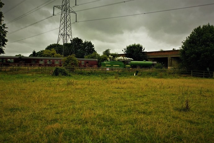

The steam train trundled on by at the same time as a regular commuter train was heading into London… :man_facepalming: Nice site to see the train though… Snagged this whilst holding the drone (discovered that the photo and video buttons work without the screen connected too!) but it’s not usable in the treasure hunt as she wasn’t flying when captured…

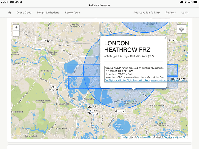

The Drone Scene FRZ shows the same area as your NATS app:

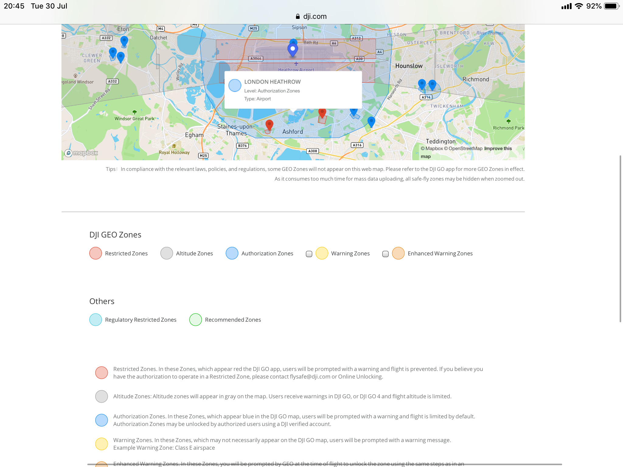

Looking at the DJI geo map on their web site, it looks like anything in blue can be unlocked:
Sorry - you’re right - it did give me the option to enter an unlock code (which I didn’t have obviously)

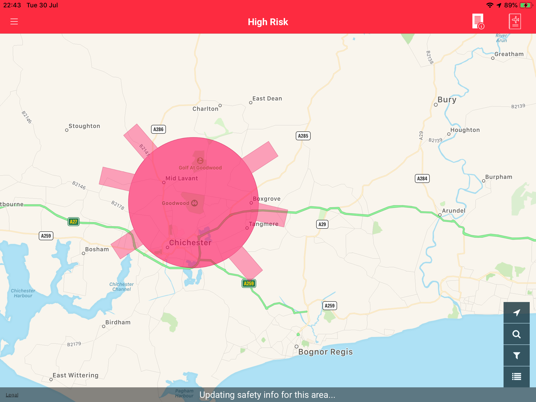

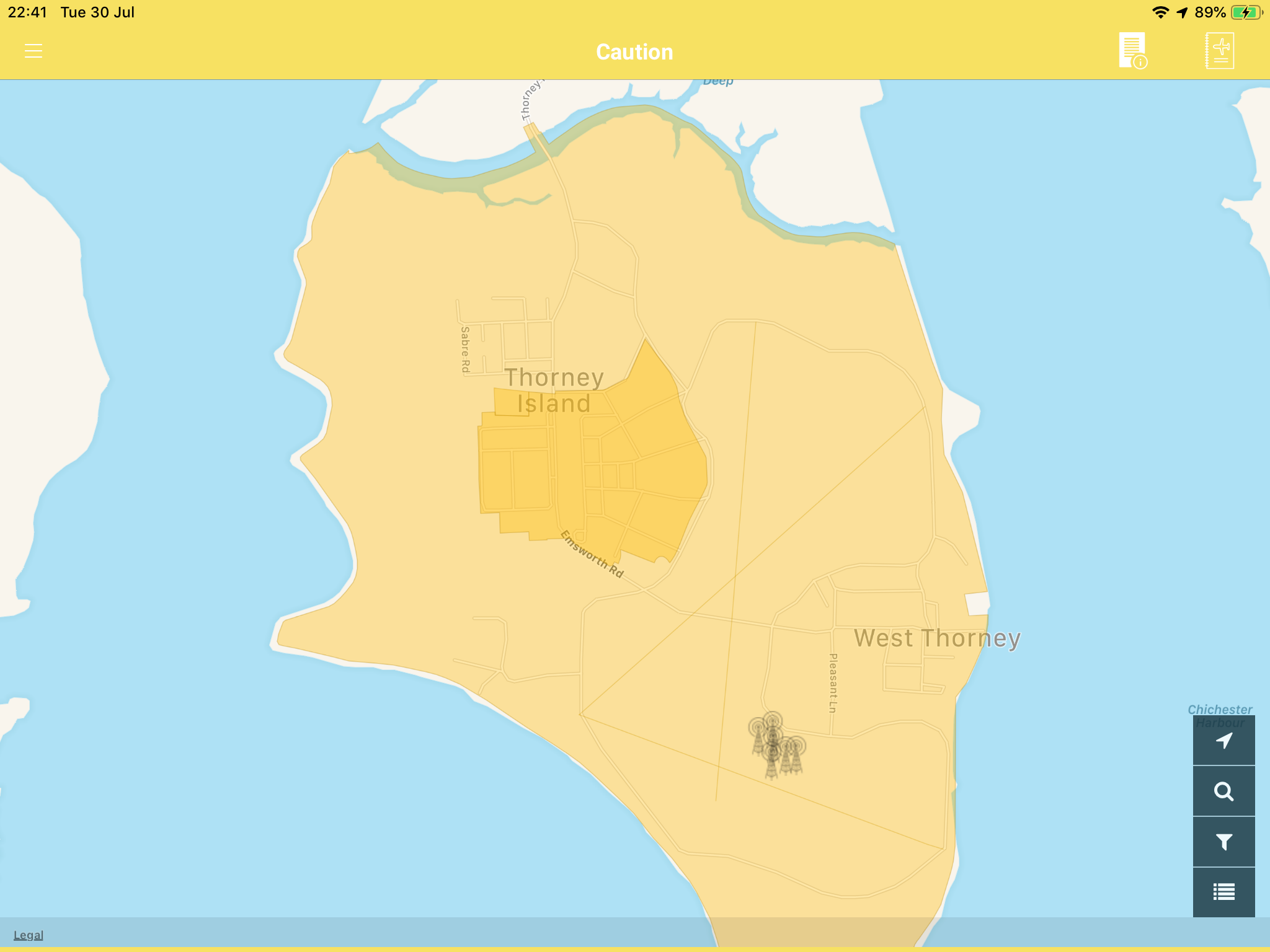

Coincidentally, I was comparing DJI Geofencing tonight as I may have a job near a military site. The site is blocked out in Blue on the DJI app, but only a yellow warning on NATS.
Yet my local Aerodrome, which has a NFZ, is not shown with any geo fencing on the DJI Geo fencing.
Am I missing something?
Is this just a case of DJI playing catch up and erring on the side of caution with larger buffer zones? As a business, it’s probably the best way to stay on the good side of public perception?
But I don’t understand why the airdrome FRZ is not shown?

That’s an easy one. Thorney Island is no longer considered an active uk airfield. Nor has it been for some years.
It continues to be assigned two ICAO codes (one military, one civil) EGUV and EGYT. But these don’t appear in any current listings.
List of airports in the United Kingdom and the British Crown Dependencies
Without checking every entry, I believe the only airport’s that gain FRZ status are those on NATS’ UK AIPs (Aeronautical Information Publications) …
Aerodromes published in the UK AIP
Thorney Island is in blue/yellow in the above maps because of its military status.

Thanks for the comprehensive reply Dave , but I think my question got lost on the thread.

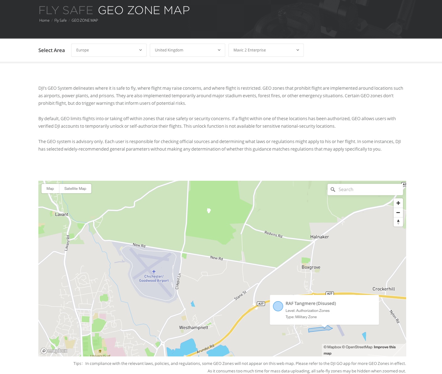

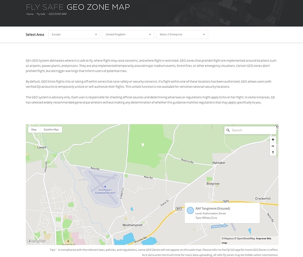

DJI Geofencing is surprisingly out of date in the sense that Chichester/ Goodwood Aerodrome has no Geofencing at all, yet the world war 2 airfield at Tangmere is! I would have thought that DJI would have all the FRZs on the system by now, it’s not that difficult!
I can understand about Thorney, was just using it as a comparison for Chichester.
Ah - you didn’t mention Tangmere previously. :wink:
But, again, it’s the military aspect that has it geofenced by DJI … “Military Zone”.
Shoreham / Bembridge / Sandown / London Ashford - none of these have a DJI geofence either, like Chichester/Goodwood.
There are a number of active airfields that are the same … mainly those with no commercial/scheduled activity.
I’m not sure that “out of date” is the term. They seem not to bother with smaller airfields.
Tangmere has been closed since the war!
As an airfield, yes. But there must be something there from the military point of view. They are not geofencing it as an airfield.
