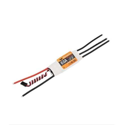

I will have to check as not sure if it is Dshot will have to check, it is a beast of a ESC as it’s 60A.

Ok after a few more hours iv got all my green lights I just have an issue with my above ESC, trying to calibrating it via the sticks isnt working hence its time to dig deep once again.
Iv checked and you can get the below which I didnt think I needed at the time of purchace, lets hope this does the trick and I can finally get this bloody plane in the air..
