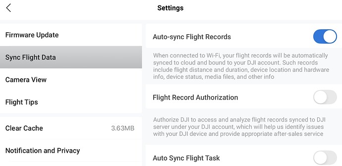

Make sure you have this toggled on -
Yep, I did everything as the guide said. It’s bizarre, that the same account is on both the controller and the phone app, but the two don’t display the same material for the same account. I can’t get my head around it at all :face_with_spiral_eyes:

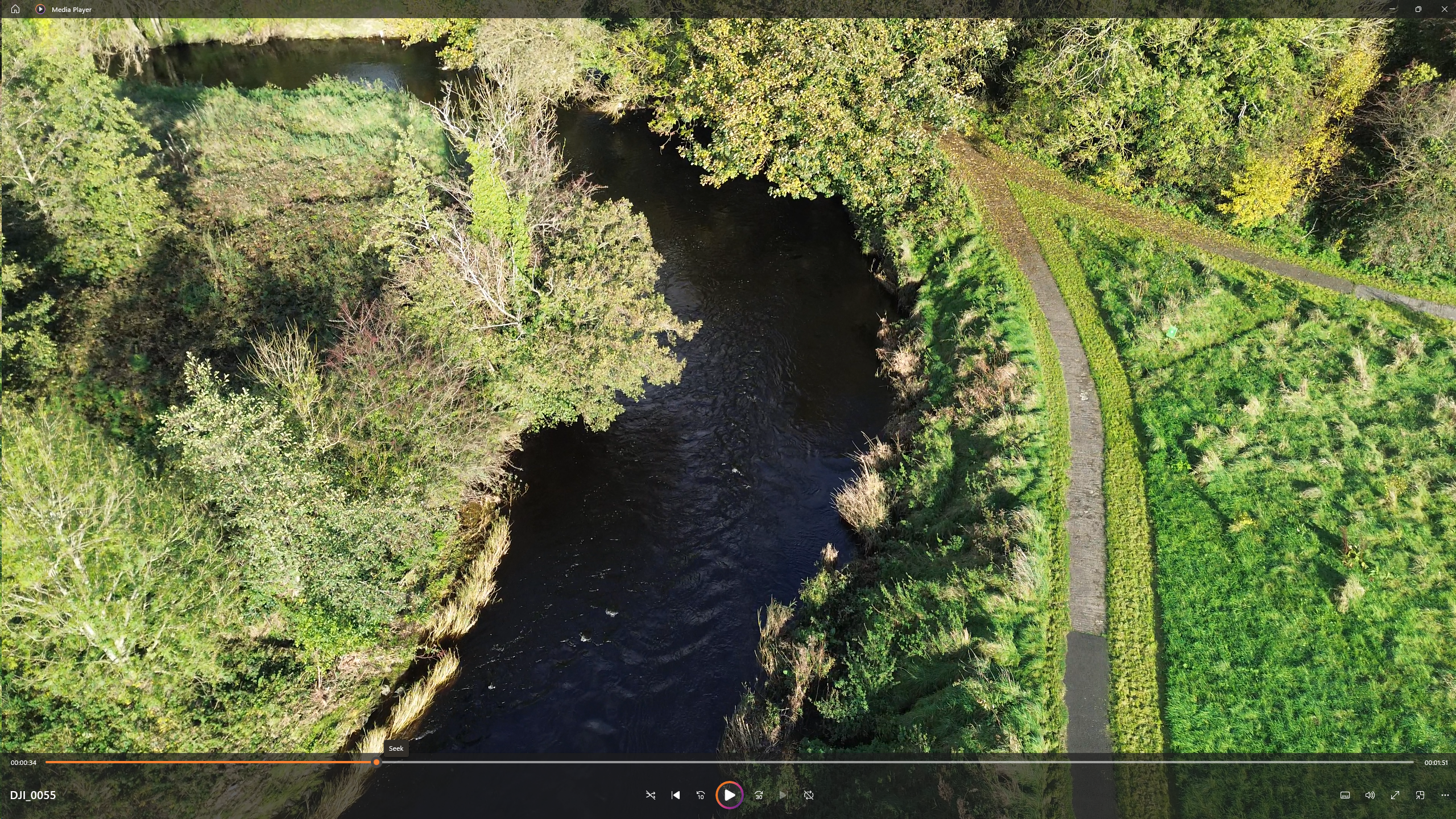

Entirely possible. In the 6 months of owning the drone this has been the worst crash so far, and whilst it wasn’t a bad crash, perhaps as you say, it knocked things out of kilter, and it’ll reset itself. The second video is so poor quality, I’m likely to have to go back and take it again. I’ve uploaded screengrabs from Video 1, pre-crash, and Video 3 post-crash, and to me Video 3 is nowhere near as sharp as Video 1.
