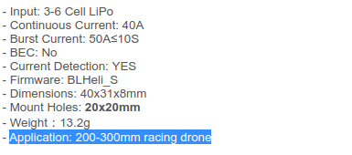

@notveryprettyboy I looked at the Spedix IS40 40A 4in1 ESC (3-6S) (20mm) and the specs said:
Selection_914

Ah yeah. It has 20mmx20mm hole spacing. So ideal for a small 3 or 5 inch racer maybe as they are short on space and have mounts suitable for 20x20 rather than 30.5x30.5. But absolutely fine for a bigger quad if it fits ok. BLHeli32 is better than BLHeli_S though if you have the option.
