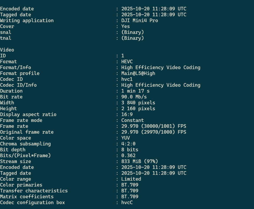

Mini 4 Pro h265 on normal is absolutely not 10 bit.
