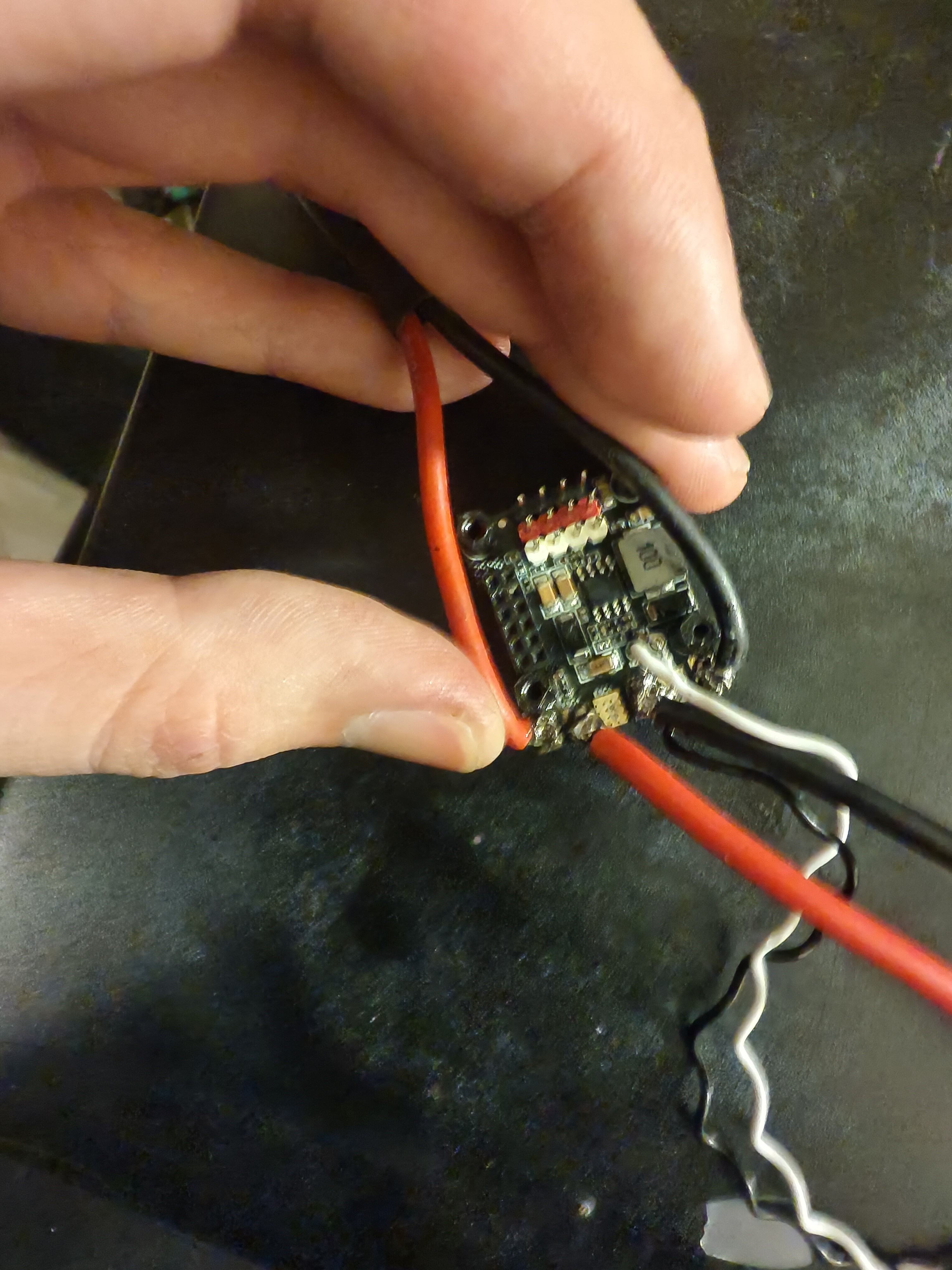

This is the holybro kakute, the board of choice for this. I soldered everything in (terrible but it’s soldered) and the esc makes a noise. The motor however does not power on. It doesn’t twitch, it doesn’t spin. I’m certain I wired this properly. I’ve used both pads to make sure I didn’t burn smth, (back seems clean). This is before touching inav.

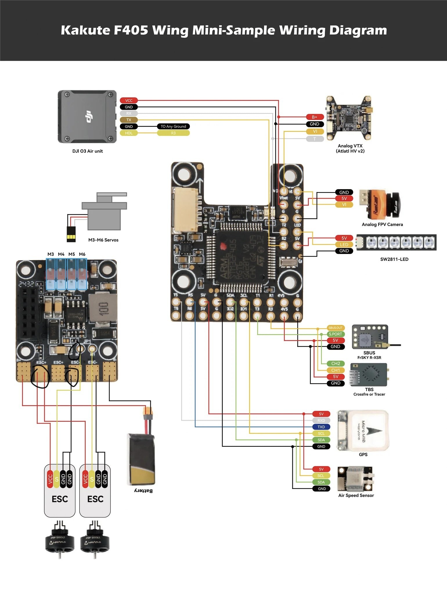

Circled in the diagram is my exact ports soldered.
You would need to configure this for your motor as you are using motor tab 2 you will also need to set the direction

Can you post a picture of the soldering

Oh Lord I haven’t soldered in ages :joy: this is gunna be really really bad. I sincerely apologize in advance
No I don’t have a smoke stopper. Also, ignoring my atrocious soldering skills, I did do this on a speedybee which didn’t require soldering of the signal and ground from the esc. It still didn’t work. I’m guessing I did smth wrong
Hey Charles do you live close to derby??? As would be happy to help..
Can you take a clear picture of the soldering and a little closer

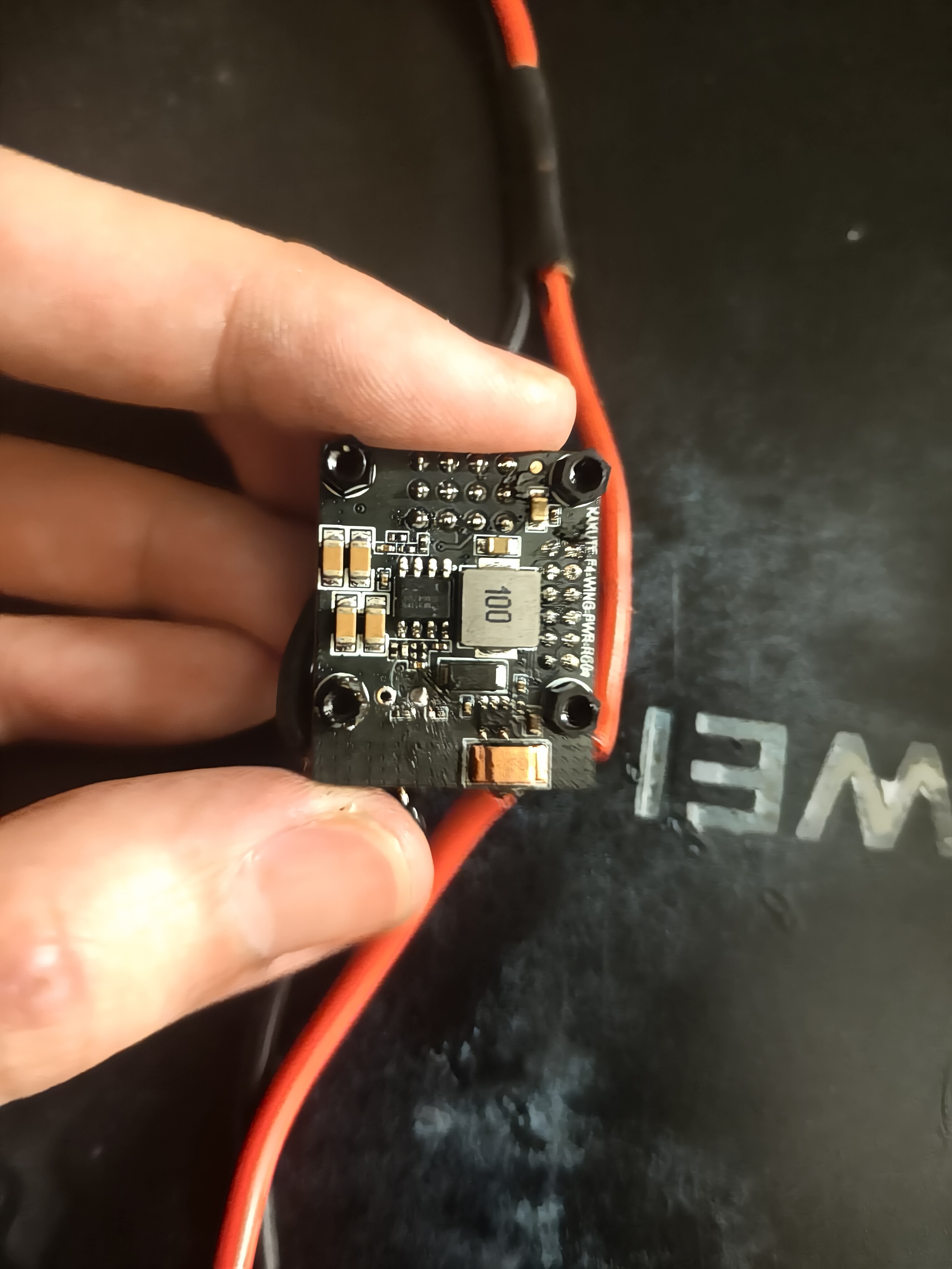

so as it turns out, i did burn out one board, i don’t know how but i’ve restarted soldering on a new one and it’s goiing much better, i definelty need to do some resoldering but it’s all now to a point where it can spin up in inav, just not without.which is the next step. after resoldering
Ok well sounds like you’re making progress, if you need help let me know :+1:t3:
re your soldering, some tips for you,
biggest tip Number 1, Use leaded solder and throw away any lead free solder you might have.
Tip Number 2, Flux is your best friend and most faithful ally.
Tip Number 3, Always tin both wire and pad before bringing them together.
Follow those 3 tips and you should be golden. :+1:t2:
