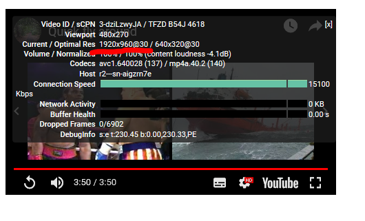

Yup - and you’ve rendered at 30fps … it has to invent those extra 5 frames every second by repeating every 5th frame, and that gives you that twitchiness.
Also - you’ve rendered at 1920x960 … which is one strange, and definition losing, resolution. Should be 1920x1080.

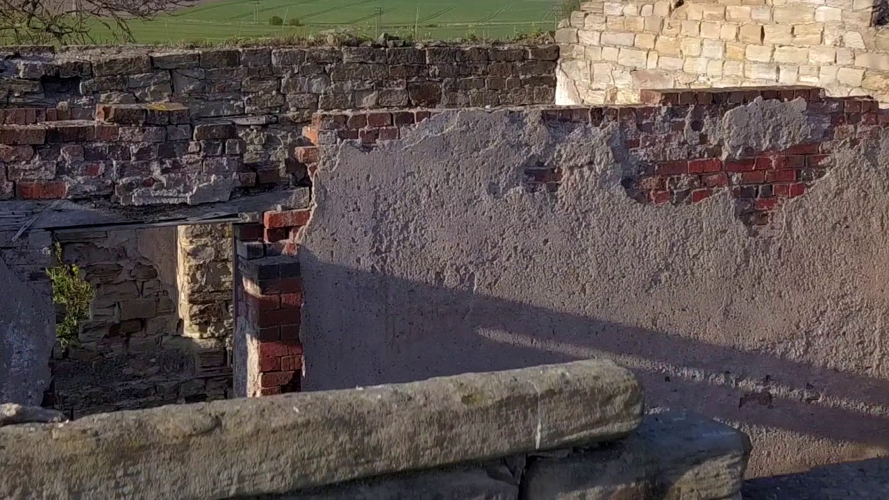

Its not the twitch it’s the flicker i am getting . I get it more noticeble when it’s close in on trees or grass .
I have to say I don’t see a flicker. At what time point are you seeing that?
Look at 2:21 when it’s panning up over the wall . The trees are flickering bad .
Also at 2:57 .

As you can see in the opening shots over the village .
This could be some kind of moiré effect of the fine detail clashing with the sensor grid as it crosses it.
