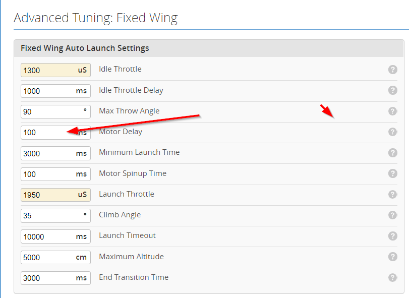

@Steviegeek seems somehow a 100ms delay being added after chucking, doesn’t explain the one that ended on floor. Better look back at the cli settings for this. I never had that delay before, strange. this 100ms for the motor spin up time (from 1350 to 1950) is fine, and will leave that.

Ended up with these!
nav_fw_launch_thr = 1950
Allowed range: 1000 - 2000
nav_fw_launch_idle_thr = 1300
nav_fw_launch_velocity = 150
Allowed range: 100 - 10000
nav_fw_launch_accel = 1250
Allowed range: 1000 - 20000
nav_fw_launch_max_angle = 180
Allowed range: 5 - 180
nav_fw_launch_detect_time = 40
Allowed range: 10 - 1000
nav_fw_launch_idle_motor_delay = 1000
Allowed range: 0 - 60000
nav_fw_launch_motor_delay = 20
Allowed range: 0 - 5000
nav_fw_launch_spinup_time = 100
Allowed range: 0 - 1000
nav_fw_launch_end_time = 3000
nav_fw_launch_min_time = 2000
nav_fw_launch_timeout = 5000
nav_fw_launch_max_altitude = 5000
nav_fw_launch_climb_angle = 35
Allowed range: 5 - 45
nav_fw_launch_manual_throttle = OFF
Allowed values: OFF, ON
nav_fw_launch_abort_deadband = 100
Allowed range: 2 - 250

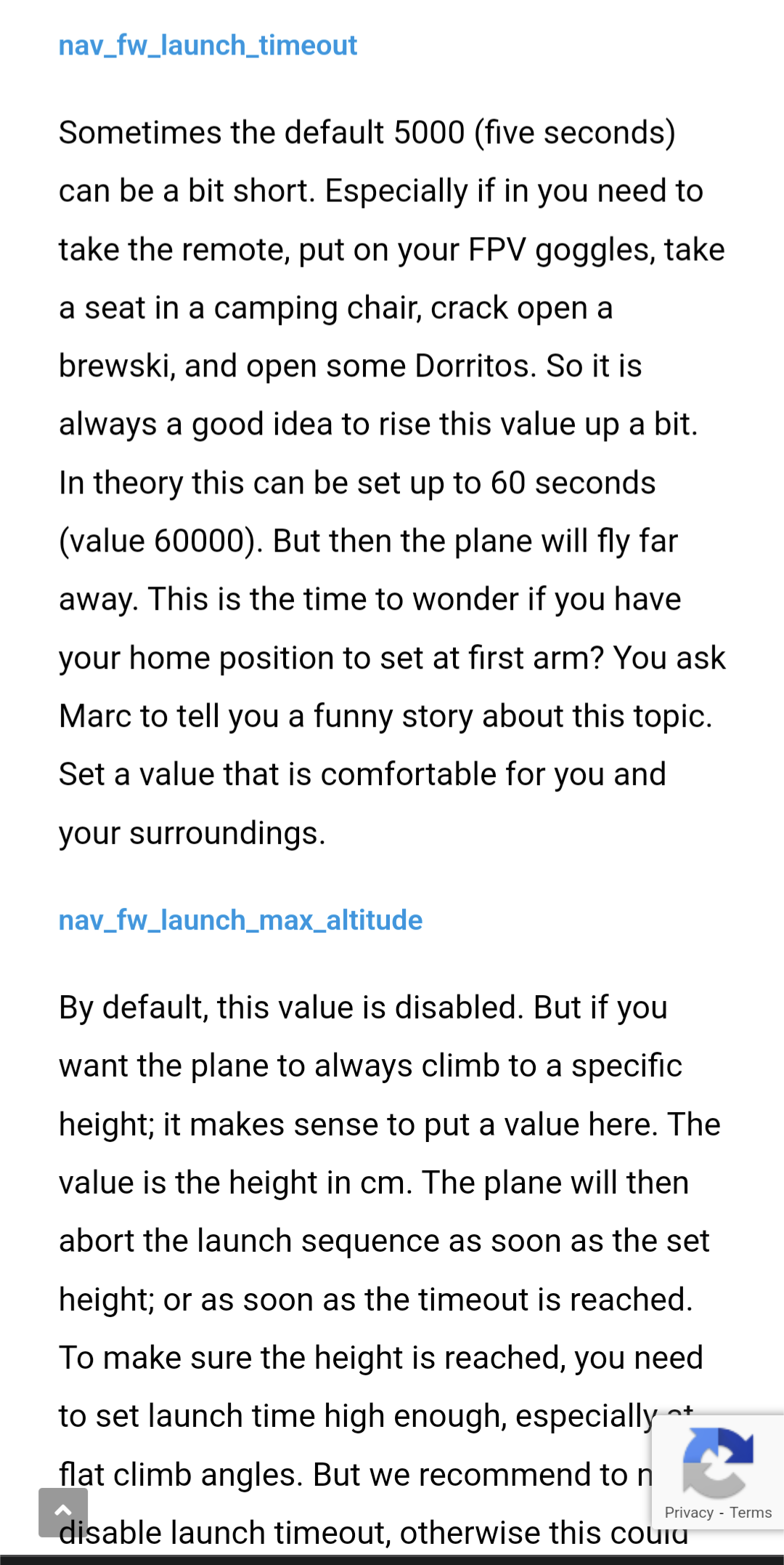

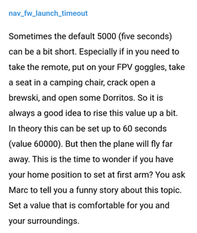

Your nav_fw_launch_timeout = 5000 is low at 5 seconds, maybe you are taking longer with your checks and this times out. I had EXACTLY the same issue so increased this to 15 seconds

I thought this was how long to launch for before loitering i.e. post take off
Nah the AR wing goes to moon…might try 90 degrees haha… It’s 20 on the ranger
That reads how long before can wiggle sticks to me. With a loiter set and height this doesn’t matter if low (I’ve now set it to 3seconds on the AR wing…)

Oh dear, it’s dropped to the ground
Because 5 seconds has passed
Ask Karl, this happened to me numerous times until I sussed WTF was going on
You can exit ‘autolaunch’ anytime by wiggling the pitch/roll stick
My only regret yesterday was when this happened to you, I forgot about my previous experience to tell you then
All this easily checked in your lounge, set switch, wait, shake, see what motor does
This why I set to 15000 (15 seconds)
:smile:
See I read that differently… It’s timeout AFTER launch… How long before it goes.to loiter or acro or angle whatever you put on… If what you say is right surely the idle would stop after my 3/5 seconds? Which it didn’t
Also it kicked to full power on ground. I changed my angle from 90 to 180 and lowered the detection speed on the wing
