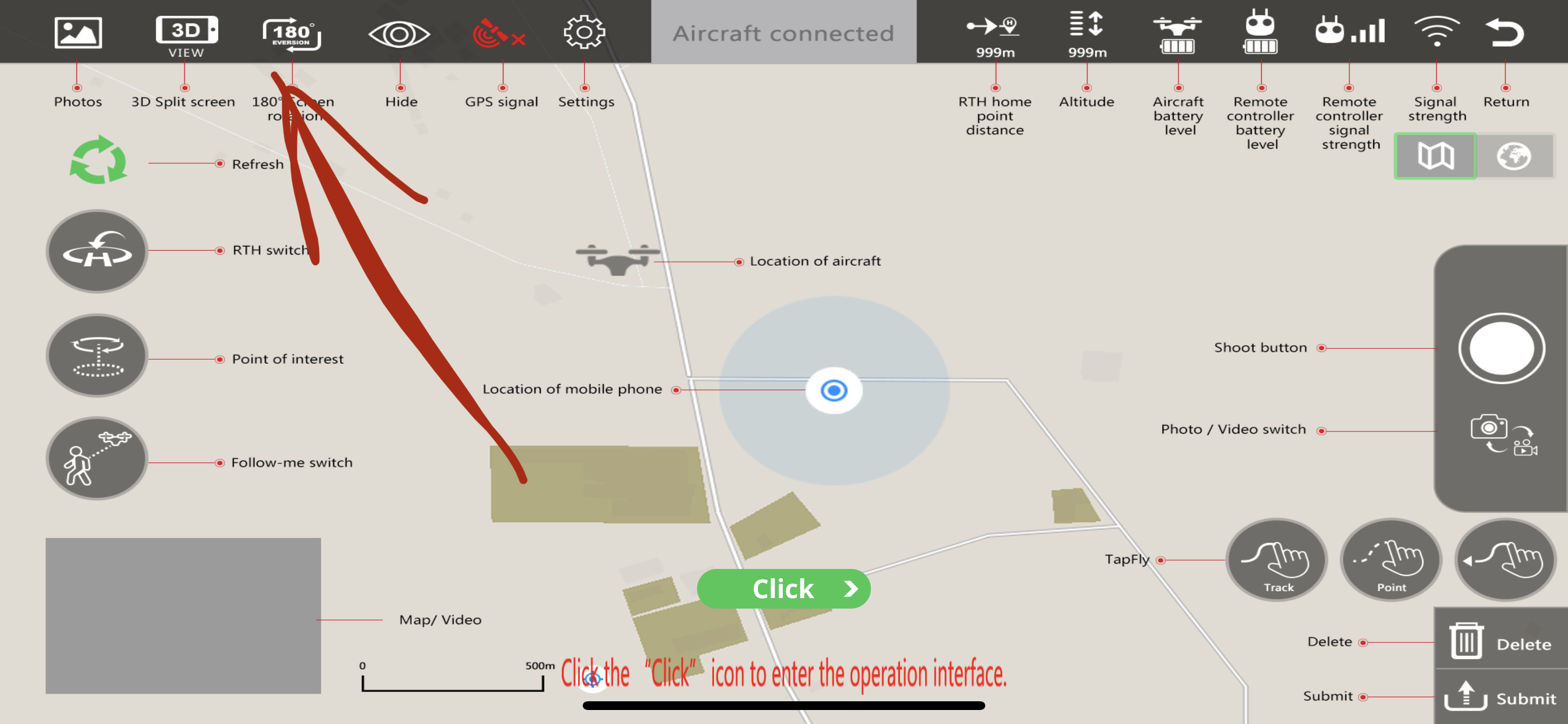

So, apparently in the app there is a 180 degree rotate button?
Nice little touch this,
Keep tapping it during flight, you will have the best FPV footage out there! Smooth barrel rolls :wink::shushing_face::zipper_mouth_face:
Does that not just flip the app screen so you can mount phone in either orientation?
I had a bugs 3 a while ago and think that app had similar.
Such a simple fix if that’s the issue.
Ah maybe… I had the 5W as my first, but can’t say I ever flipped the screen. Worth a shot though, sometimes it’s the simplest of things. :man_shrugging:t3:
The 180 degree rotation button cracked it.Thanks a lot. Stupidly didn’t think of that. I thought the problem was which the camera electronic board. Thank you and the other members that answered. Incidentally, take it back about MJX HGK they replied within 24hours with the same answer 180dg button.
