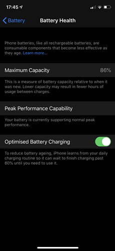

What others said check the health of the battery opposes to the charge.
It might display 90% but if it’s only got 40% health to start with your fooked.
Settings - Battery - Health
