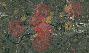

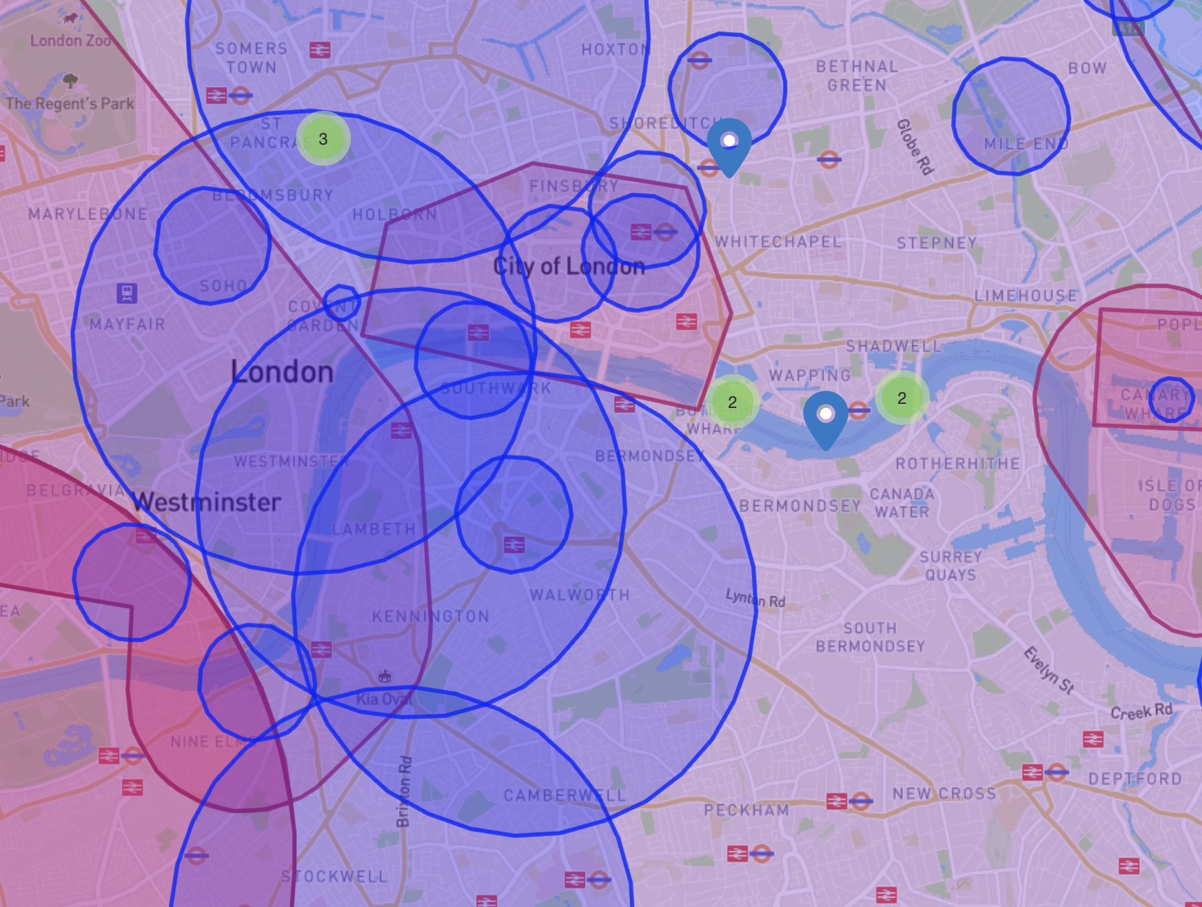

Anyone who flies or has flown in central London this year will be aware of the seven Temporary Danger Areas centred on seven Metropolitan Police stations to allow them to trial beyond visual line of site flights. They are calling these Drone as a First Responder, or DFR trials, and at each location there are restrictions from the surface to 600ft four nautical miles wide.
EGD186B - Islington
EDG186C - Charing Cross
EDG186D - Kennington
EDG186E - Kensington
EDG186F - Walworth
EDG186G - Stratford
EDG186H - Brixton

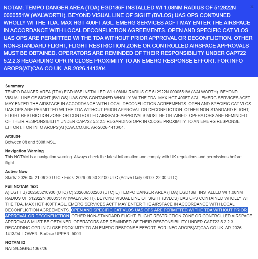

I presume we don’t have to request permission anymore to fly in the Drone as First Responder (DFR) trial TDAs, based on the updated text in the NOTAMs.
See the bit below highlighted in blue in the full NOTAM text:
Is that everyone else’s understanding too?
