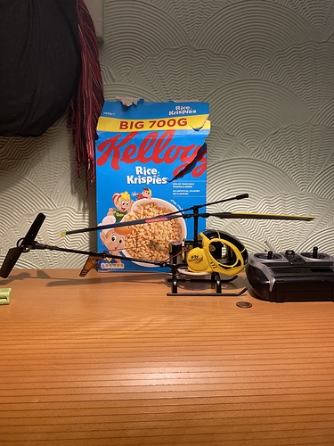

Hi digging through the ‘never regions’ of the house today I came across this Totally forgotten I had it !
Expecting battery to be totally defunct but not mega bucks to replace & I will need a charger
So where do I go for those I’m open to suggestions but I think I’d like to keep the battery pack at lease as near to original spec as possible.Certainly don’t want to effect balance of machine

It actually quite big the pictures are a bit deceiving …

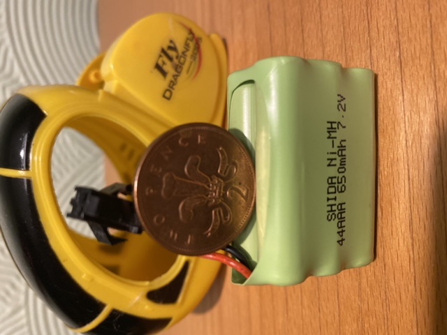

Ok so that’s nihm pack 4cella I’m guessing in series so
1.2v/cell x4 = 4.8v nominal
Can’t recommend batteries but the pack is made from 4 AAA rechargeable cells
Chargers wise they are bog standard rechargeable aaa batteries so you don’t need any special chargers
Just for clarity it’s actually 6 so 7.2v But Thanks I appreciate your comments

6 aaa at 7.2v
You could easily get a 2s lipo the same size with a much higher capacity

You need to know the physical size of the pack. The kind of connector it’s using. Then go find a 2s lipo that fits

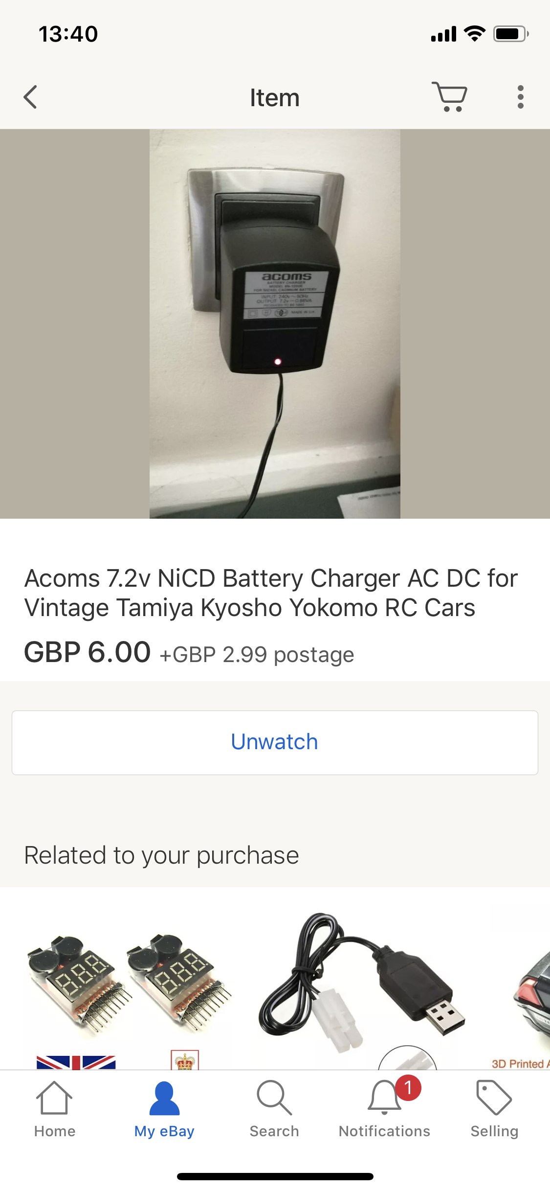

Bought these today so here’s hoping I’ve got it right
Well it’s a nicad rather than a nihm and the batteries are AA sized rather than AAA
so yea the battery will be way to big!
Also the wall wort charger will take forever to charge the pack…
Other than that your golden!
Yes thanks for that I should have asked 1st but very few helping me here With any detail I’m afraid :hugs:
