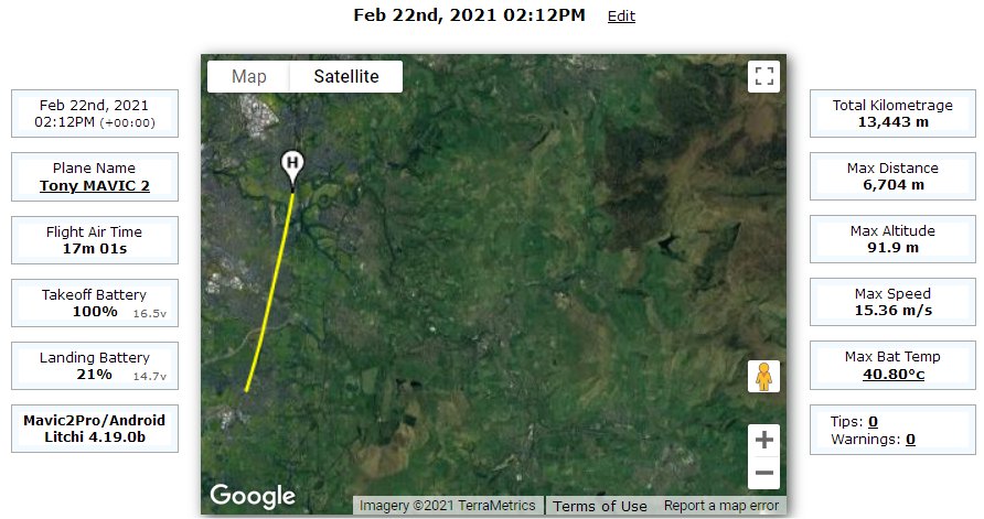

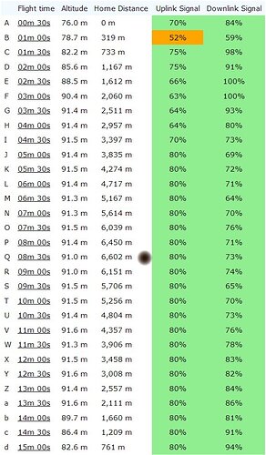

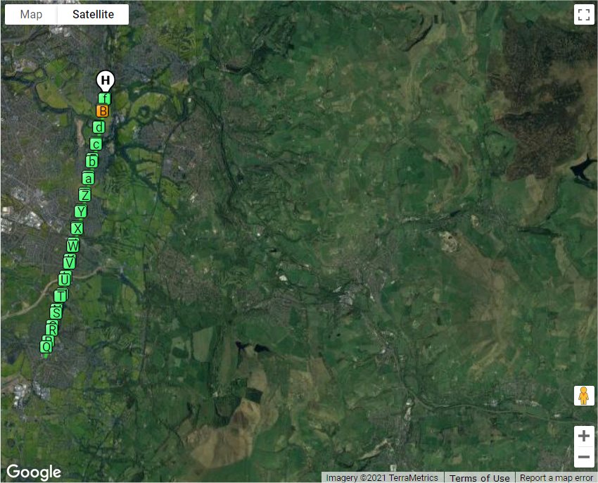

When DJI et al advertise the maximum distance / range of a drone they’ll always quote FCC figures :confused:
Eg:

At the distances in the above screen shot, you’re probably not flying VLOS at all (during daylight hours at least).
