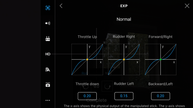

As suggested by @OzoneVibe here’s screenshot of the settings.
image image
Only by going back to this today I found the rudder left setting was for some reason on 0.95 so I reset it to 0.15 and carried on setting it up,
Then when I went back and double checked setting it had reverted back to 0.95 again ?
Rechecked again since and it’s now holding the setting, now to me that is wierd, it’s like it’s taking 0.95 as a default setting.
Soon as the wind drops I will give it a try again.
That setting is for expo, it reduces sensitivity around the centre point of the sticks.
0.95 seems odd as max on mine is 0.8 and would be far too aggressive.
0.15 should work well.
I cant remember if switching to sport mode gives different values.
When you are yawing, are you moving the stick slightly or going full deflection? If only slightly a high expo would explain your issue.

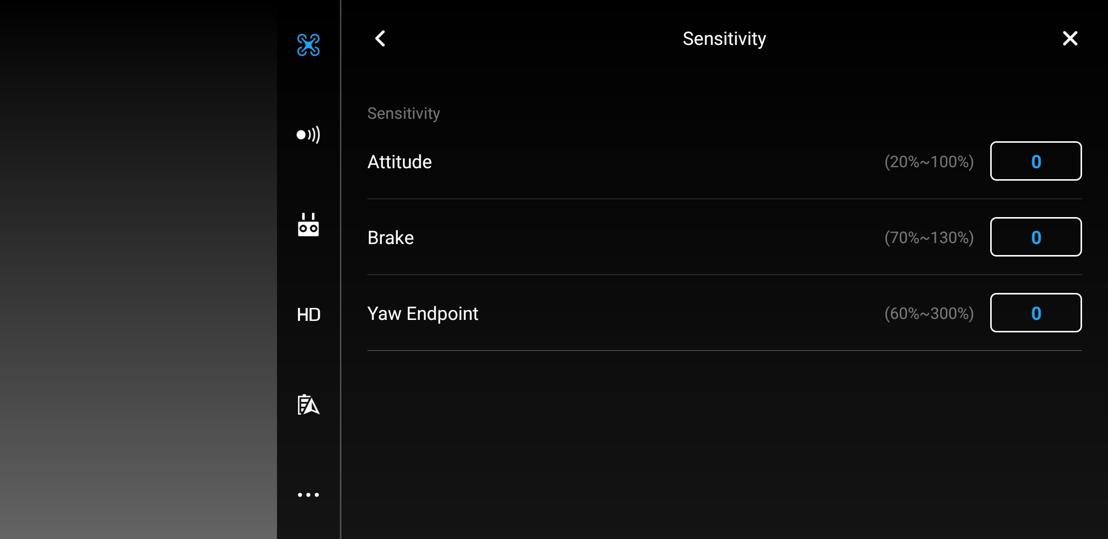

You might also want to adjust yaw endpoint. It reduces the rotation speed at max stick deflection. It’s under sensitivity.
I thought I did that but will double check!
