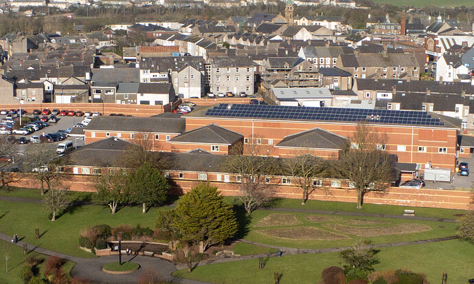

Just fitted some new props to my little drone, so out to the park for a test flight. I figured it was an ideal opportunity to prove a point I made earlier about telling height and location of a drone from a photograph.
what i done was zoom and snap a photograph of the local comunity hospital from the park,
then from the exact same height and postition took a 360 pano.
I have cropped the photograph too, but you see how difficult it is to tell my height and position from the single shot, the pano gives you a much better idea as you have more reference points.
I promise both shots are from the same same location and both are from a height of 50m
Well done!
The only way to tell a drone’s position from a picture is if it is looking straight down. Height would still have to be an estimate as fields of view of different lenses on different drones will give different impressions of altitude.

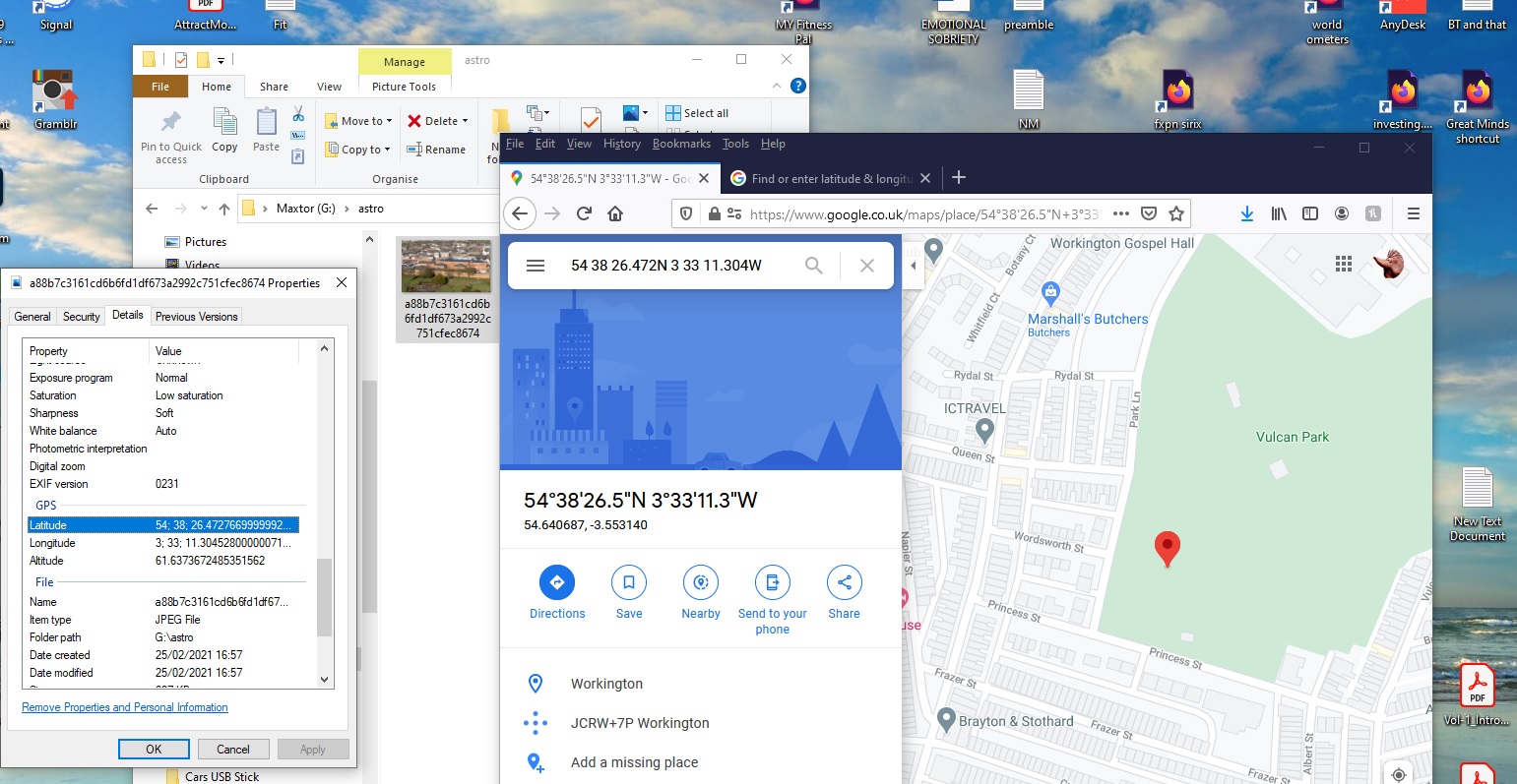

If metadata are preserved it’s a lot easier. You’d be surprised how much exif data there are on a dji photo.
I just learned something really epic, i wondered how you would get the focal legnth, I know you cant do this from facebook but this forum actually gives lots of info when you down load a pic. I downloaded my image then went to properties and got alsorts of stuff, even the GPS location. I still argue with the height though I was at 50M not 61, but the location is bang on.
Oh, wait, the drone is giving me height above TOAL point, the GPS unit will be giving height above MSL.
There’s waaaaaaaaaaaaay more info there than what Windows will tell you.
All the altitude information is very inaccurate. But if you know true altitude at TO, you can get very accurate MSL and AGL from the drone.
I’m not sure what more is left to tell me over what Windows carries.
Just have a look and you’ll see.

Here’s one suggestion, as @dulcificum doesn’t appear to be very forthcoming:
https://exifinfo.org/
Excellent resource, heres a random shed shot for info
https://exifinfo.org/detail/rBCtOl-0wdhNIUGe_XIuhA
To view exif data, any software designed to view exif data. Even a hex editor will do the job if you prefer that. Exiftool is the industry standard but as I said there are dozens of tools and it’s there in plain text for you to read.
