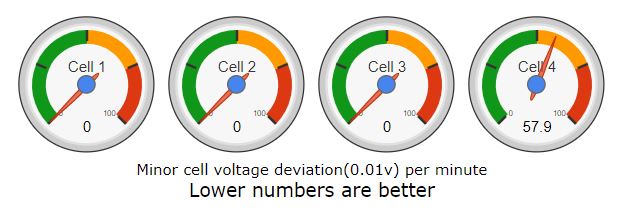

Hi I was reviewing my flight logs in AirData UAV the other day and noticed this:
batteries
I have two batteries and both show similar discrepancies on cell 4 and looking back through my flights I see the same to a greater or lesser extent on each flight.
Should I be worried?
What does GO4 say?
Do you know I never thought to check, no warning came up but I’ll check the log.
Sorry, I meant, while the drone is powered up and in flight (just keep it low) so the batteries are having some decent current drawn from them.
Go in to the battery details in the GO4 app and see how the cells look?
Ah ok, I was wondering as I couldn’t see anything in the app indicating a problem. :thinking:
There might not be a problem at all - Hence why I asking how it looks in GO4 when under load :slight_smile:
