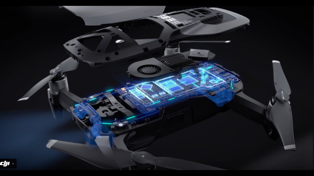

It could be worthwhile calibrating the IMU and the vision system.
IMU can be done with controller and phone / tablet. You will need a flat surface to place the aircraft on. No idea why the video thumbnail is showing an exploded view, there is no disassembly required - it’s just slightly more cpmplicated than compass calibration.

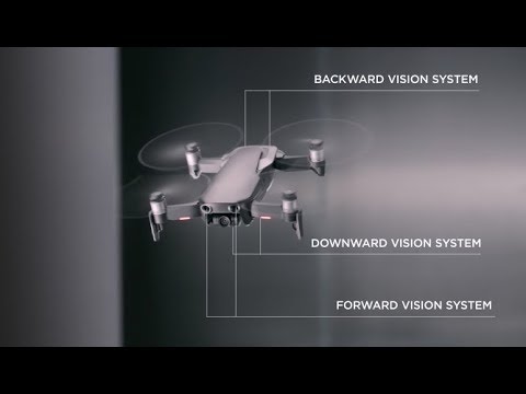

VPS calibration needs a PC or a Mac to do this. Probably not required but worthwhile as part of scheduled maintenance.

With regards of the VPS calibration, again, I managed to get it done in the past (I battled with different versions, drivers and all sorts until it worked) haven’t tried again. I think it might be due.

The IMU calibration isn’t that clear - or I was having an off day. It tool me a while to work out the positions the process wanted me to place the aircraft so I had a couple of false starts. Once I’d sorted that out it was an easy process.
I agree, @macspite, the IMU calibration it’s fairly easy.
The VPS on the other hand, is more unreliable than a 1970s fiat panda, and that’s saying something.

With regard to the VPS and obstacle avoidance calibration, if it’s the same as the Powervision PowerEgg X, I found the best results were obtained with a dark background behind the computer’s screen so providing a greater contrast.

I have calibrated the controller and the IMU, it seems that it’s the trick. Also, as I have not used it for a while it asked me to calibrate the compass, but that’s something that I have to do often anyway.
