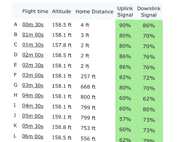

Flew a bit further out today, still windy so until I know it’s limits I don’t want to push my luck.
Anyway 570ft out and despite its tiny size and no strobons fitted, it was still quite visible in sky.
What impressed me though, was the signal strength.
Flawless, is probably the only word I could use. And considering I flew it down a WiFi corridor of housing estates, even my MP has interference issues on the same trip.
Similar flight, with the MP, check out the difference:

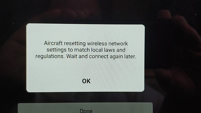

@PingSpike Wondering if you got this message when first firing up the mini? I get this on the 2 Pro when travelling to the US and then back again. This looks like an internal amendment of the transmission power, so I’m wondering if there really are two separate models…?
@ianinlondon Yes mate, I got the exact same message the first time I powered it up. I’ve not seen it since (but then I’ve not changed region).
Moved your post over to this thread on Mavic Mini FCC too - see first post and I’m now 100% sure there is only one hardware chipset and that they’re handling this through firmware, which DJI have always done anyway :+1:t2:

@PingSpike How are you producing the percentage uplink and downlink table above? I did do a long range test today; this woudl be great to see how it faired…

They’re screen shots from AirData logs mate. I noticed here though that the Mavic Pro lists uplink separately from downlink whereas the Mini only lists a single value. Level of Ocusync detail vs wifi I guess? :man_shrugging:
