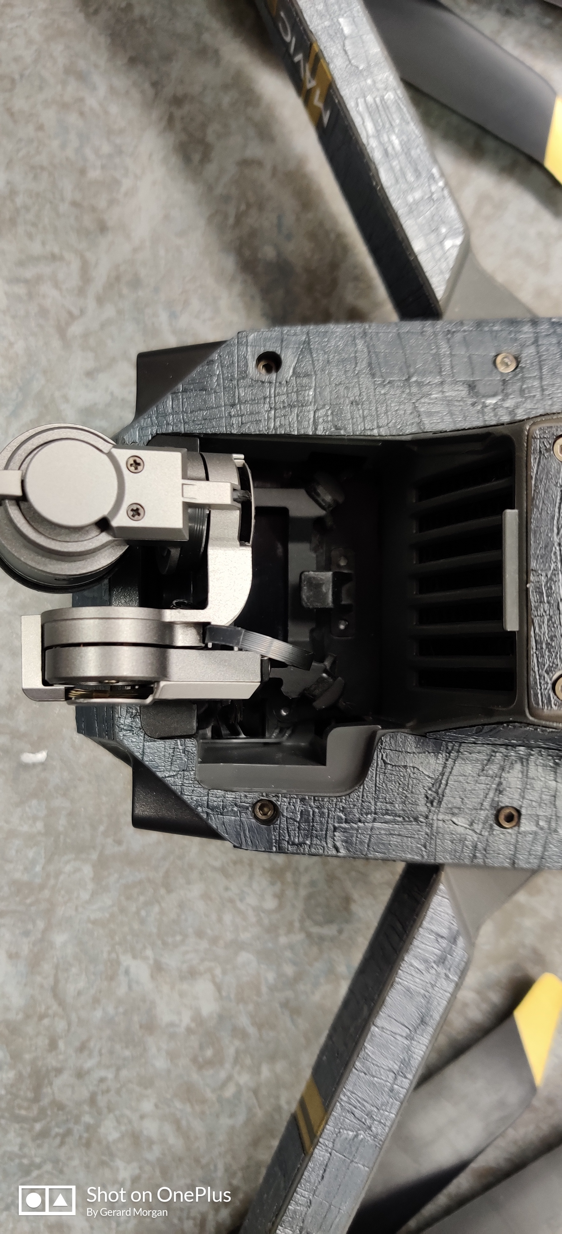

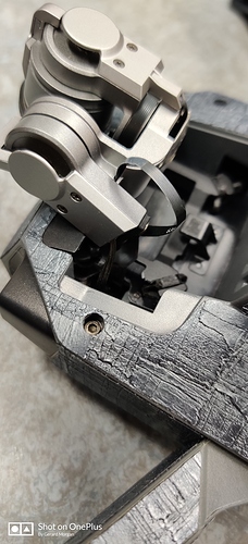

Afternoon all. Had an incident whereby the gimbal has come away from it’s mount. Ribbon is fine and camera feed good with no obvious signs camera itself is damaged. Anyone in the Cardiff area have experience of repair please? I’ve ordered new mount which arrives Tuesday, and watched a couple of vids. Not feeling hugely confident for repair.

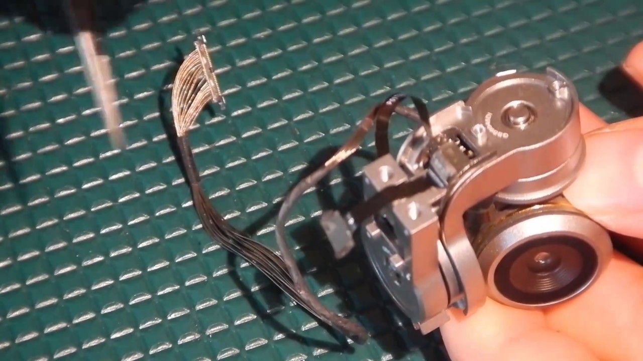

In my experience, ordering a spare ribbon cable, in case, is a small investment to avoid yet another wait.
I don’t know which vids you watched, but this is the one that got me through it OK.
This thread might be worth scanning through, too : Dismantling the MP Gimbal Mount ... and Gimbal! - a few of the pitfalls there, that you can avoid if you know in advance.
Should you need to replace the ribbon, this is the vid I followed, by the same person.
