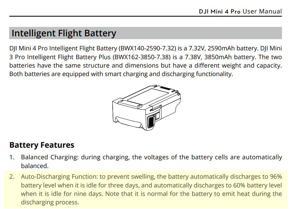

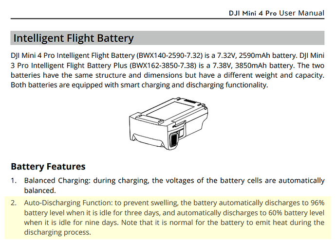

Page 63 of the DJI Mini 4 Pro user manual is also your friend (the yellow highlighting is mine):
