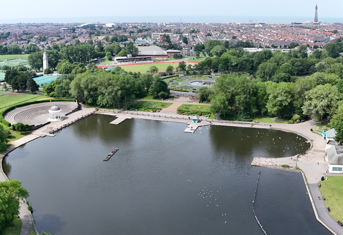

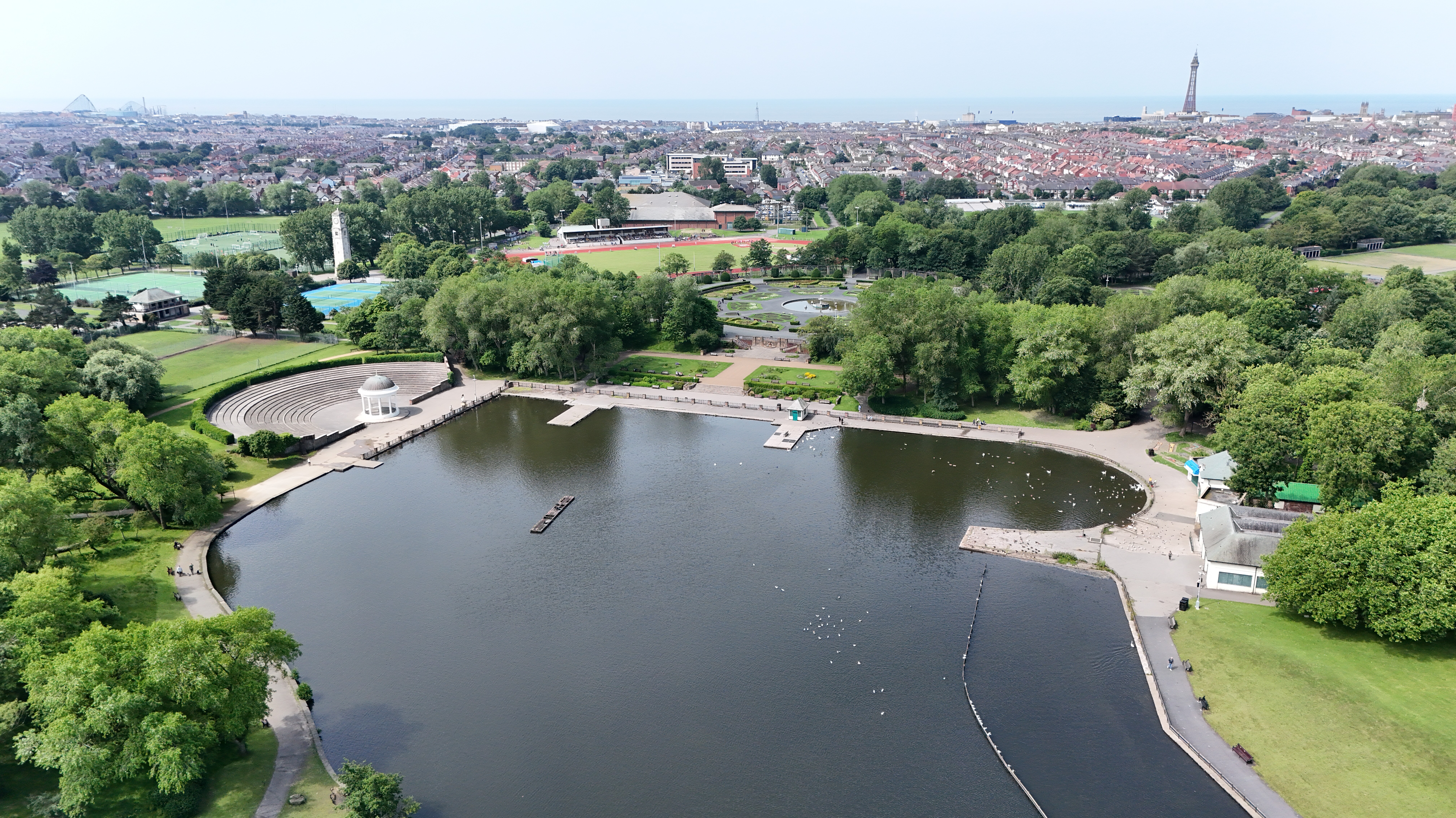

I seem to have a problem with distorted verticals, particular at the edges. Has anyone else noticed this issue? The picture below illustrates what I mean. Look at the tower and also clock tower in park. Also visible in video footage. Can’t find any lens corrections for it in Lightroom.
The leaning tower of Blackpool is new since we left in January :rofl:

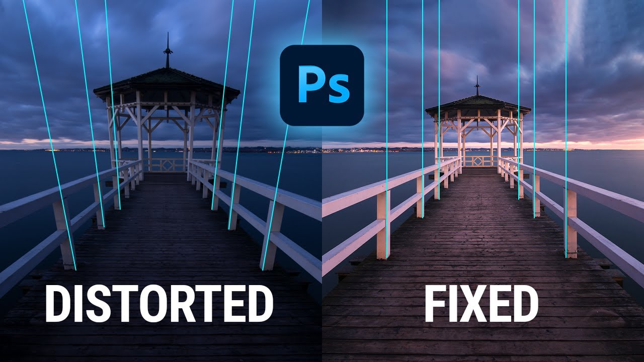

Try this fellas method it’s for PS & Lightroom :+1:
This was just a quick bash in PS, horizon could do with a little straighten but just showing for reference hence also why I cropped in, also statue to the left is on the wonk.
Cheers @kirky. I’ll have a play, though it’s a bit of a pain that I have to. The images from my mini 2se & m2 pro don’t exhibit this problem. A bit disappointed with the mini 4 pro in this respect, considering it’s in the region of 4 times the price of my 2 se.
Yes understood - been wondering what may cause it :thinking:
But regarding the straightening of things, it can be a bit of a faff as you get one thing right then it throws summit else skewed - just needs a bit of playing with, I find it a nightmare myself tbh & is probably one of my most hated things trying to correct,
You haven’t got a wide angle lens on the drone have you ?
Edit : maybe worth raising it with DJI if it’s always a problem ( isolated case ) with your drone, not sure if I’ve seen anyone else mention it.
No, it’s just as it came from dji. Has any other mini 4 pro owners noticed this problem? Or is it a fault with mine?
Contact DJI
The lens on a Mini4 Prohas the same field of view as a 24mm lens on a 35mm DSLR or film camera.
It is considered a wide angle lens - the “standard” lens for a 35mm camera is 45 to 55 mm focal length.
Any lens, even the wide angle on a DJI or 35mm camera will render verticals vertical if the lens is perfectly level, if tilted up or down the verticals will be angled. The wider the field of view, the more pronounced the effect.
There is nothing wrong with your lens.
Ah! Thanks, I’d not thought of that that makes sense for some of my closer shots of the tower. May be the next upgrade should be to include perspective control. :grinning_cat_with_smiling_eyes:. Though still not as noticeable on the mini 2 se or M2Pro which are similarly wide angle lenses.
