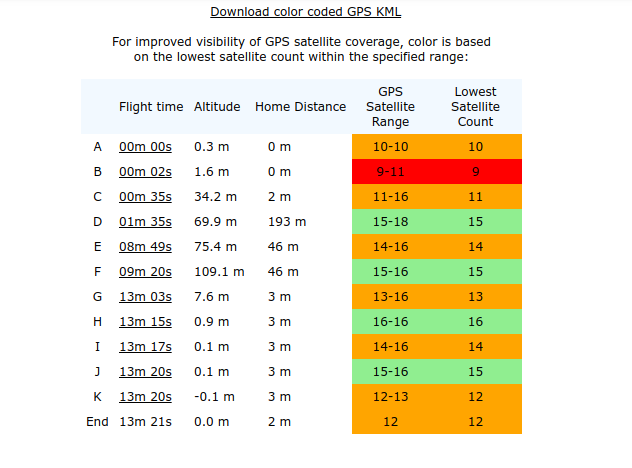

This is a post from my Airdata log from a flight I did today looking for a wee dog in woodland. Airdata seems to regard 11 to 16 as so-so and below 11 decidedly iffy. YMMV
Screenshot_2020-06-02_21-32-34
