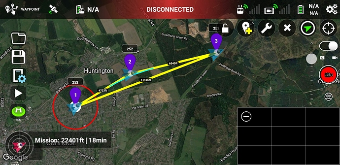

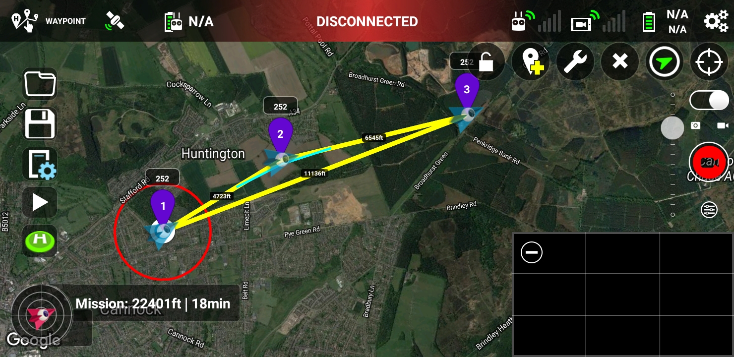

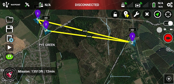

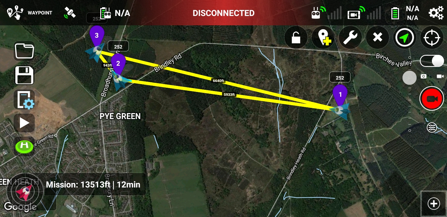

It looks good to me, providing no wind on the day then this length flight is achievable.
Check height is plentiful, when I went out to the tower on Sunday I flew at 50 metres
Make sure you identify some suitable early landing spots in case you need to abort the flight. Litchi should abort early automatically if it thinks it can’t get back home but it would be good to have an emergency plan and a mate with a car to retrieve it for you if needed
Cheers
Steve

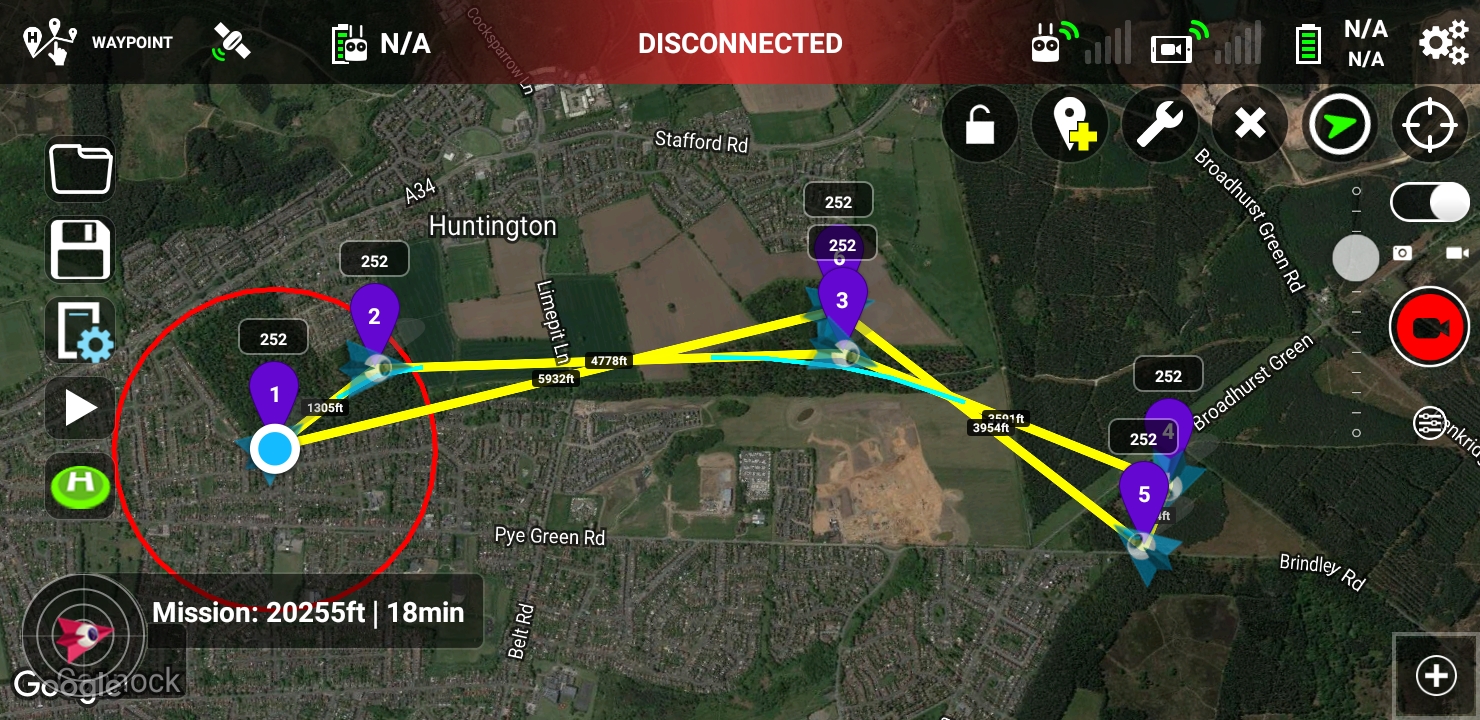

Done a different one so I’m well away from built up areas and set it all at around 250ft so it misses masts etc
When are you thinking of?
Sunday again weather permitting but done a route from the place we were on sunday around the tower and back to the triangle 12 mins flight

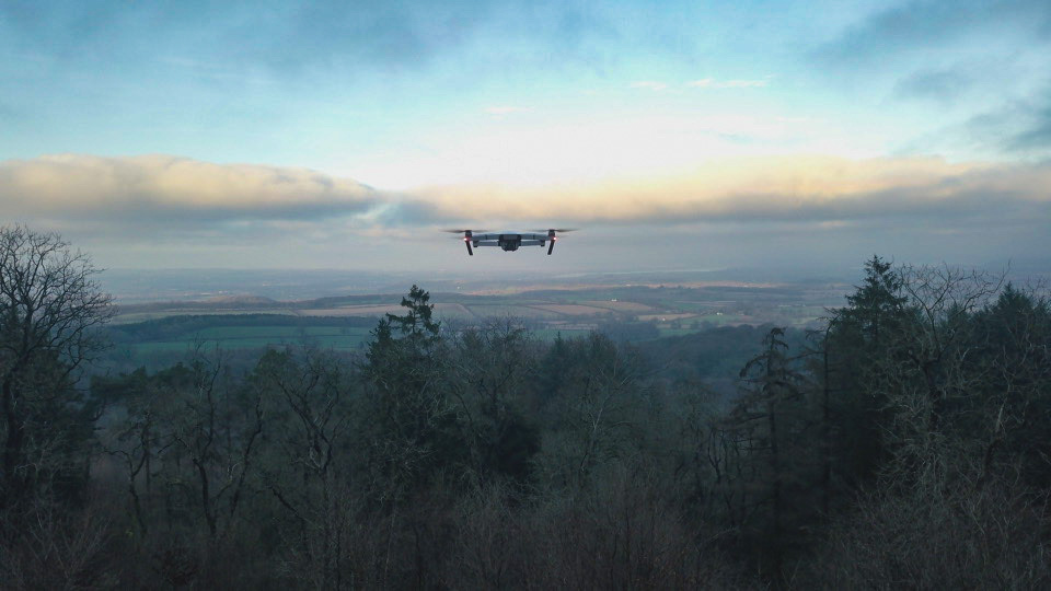

Nice little screenshot from a video of the bird in front of me yesterday over looking the Somerset levels.
Stunning shot
