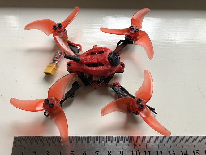

Sooo quick - and I haven’t tried 3s yet
Is that a toothpick? What’s the spec?
What’s the parts list?
Indeed - toothpick
Primo 08xx conversion kit - V080x - I got a £15 import charge for this
1102 9kv Happymodel motors
Crazybee F4 Pro v2 Frsky
Happymodel 200mw VTX & Caddx EOS Cam nicked out of the TrashMob
GNB 2s 450’s and the 3s 300mAh HV that came with the Mobula HD when I get to the park next, I have a feeling I’ll need the room
Here’s a size comparison with the Mob HD…
…I also picked up some bits for a tiny bit more range seeing as it happily cruises for 8-10 minutes
(I’ll probably not be using that antenna on the rx - I picked up the wire version too)
Are they 2" props? And 200mw vtx. Nice.
65mm - I’m glad I bought lots of spares - sort of - I’ve already bent a shaft (1mm)
I’ll be getting some of the Avan Tri-blades and screwing them on as soon as I can find them in stock somewhere
The 200mw is a bit lacking when I compare it to the 600mw VTX I’m using in the Trobula™

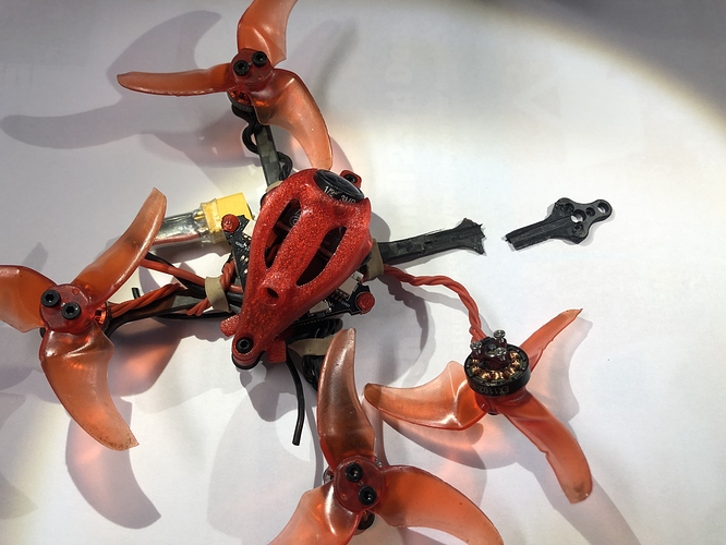

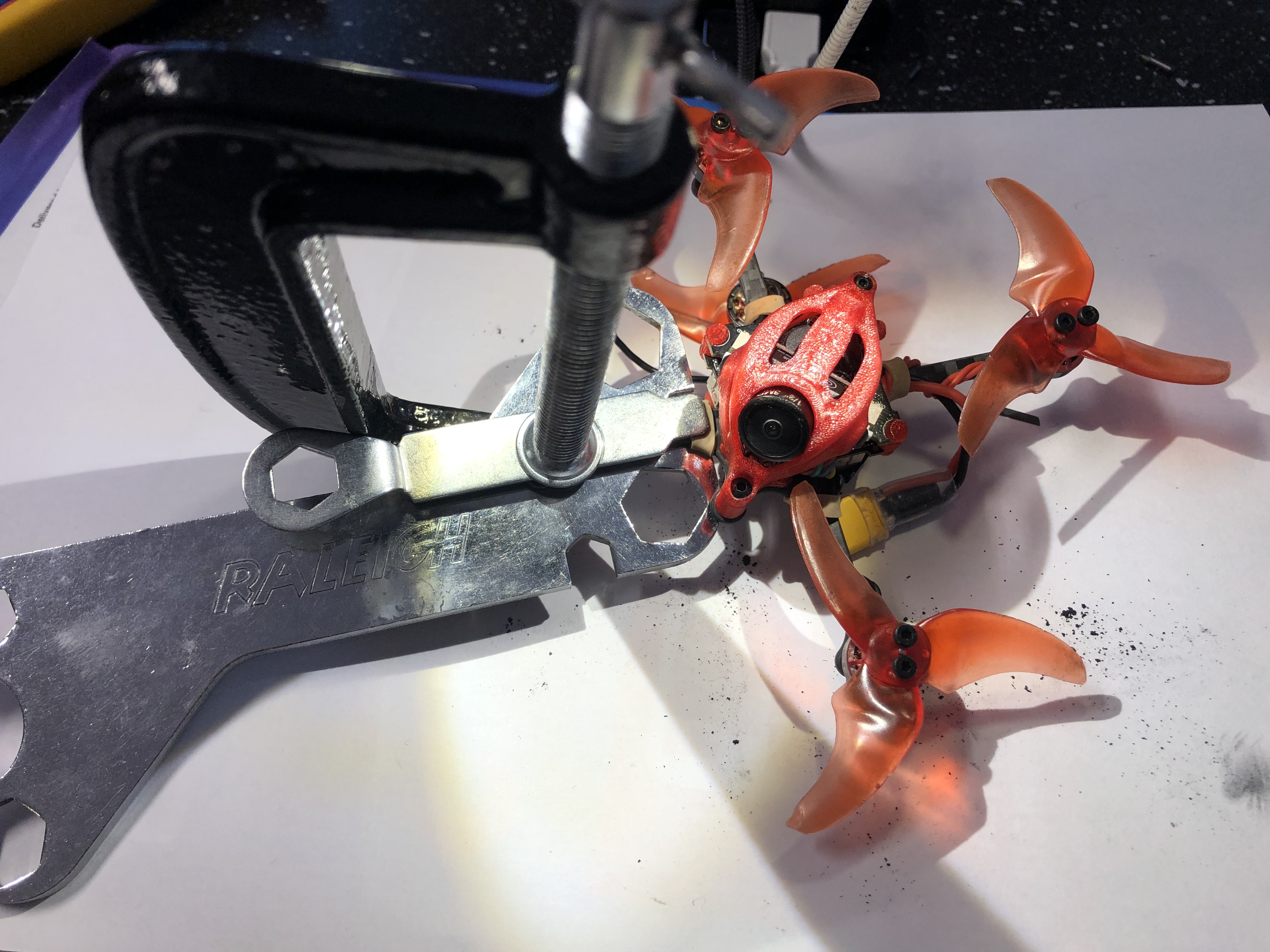

I suppose I should show the inevitable end to it all when I got a bit too cocky …
Add some graphite and some Super-Glue…
Put him in a splint…
…and Bobs yer uncle
Still Alive!
Nice repair!
