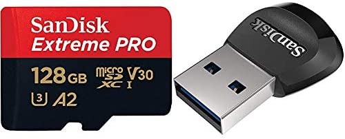

My SD card is a 128gb Sandisk extreme pro. It seems I cannot edit the post above to get rid of the my address & replace the video dowload link with the youtube one.

Hmmm. Yes - it looks similar, and costs about the same.
Your video symptoms are very inline with a card that’s not fast enough so, were I in your position, my first step would be to get another card to check things with.
At the end of the month I will invest in the extreme pro that you’ve linked above. Hopefully the weather will be on it’s best behavior then. in the mean time I’ll see if there is a way of checking the card’s authenticity.
Will capturing video at 2K or lower res’ eliminate the issue?
If speed is the only issue, then lower res could work OK.
I’d start at 1080 and if that’s fine, at least you know the P4P is fundamentally sound.
Then increase res/frame-rate in steps to see where it starts to have issues again.
