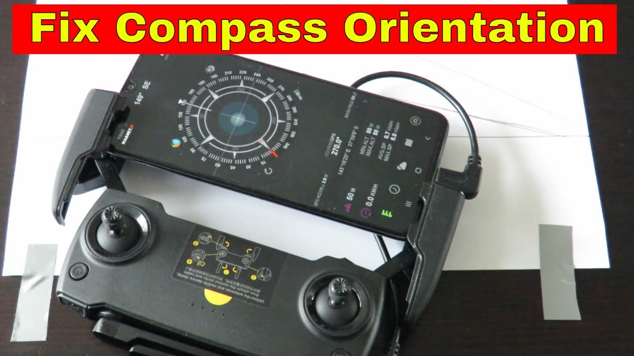

Hi Overthehill I just had a quick google and found this on youtube.
Looks like its probably an issue with your phone rather than the Mini. It says you need to calibrate the compass in your phone if its working but not accurate and if its red then the GPS is off on your phone and you just need to turn the location on in your phone. Hope this helps :slightly_smiling_face:

Just had another quick look on you tube and found this. I suspect this is your issue and may well be a solution for you :slightly_smiling_face:
Thanks for the link Sir Gunner. I think my problem is far worse than on the YouTube video. I have heard that if the phone is put in a holder it would solve this issue. The phone would then be several inches away from the controller. A longer cable would also be required.
Checked the compass reading on my iPhone. North was pointing north. Attached to controller. Flew for twenty minutes and landed. Checked iPhone compass again. North was pointing south!!! Disconnected phone from controller and the needle did a 180 degree sweep. North pointing north again. Go figure!!!

Did you try rotating your phone 180 degrees in the holder and leaving a gap between controller and phone like in the video?
I couldn’t because I haven’t got a long enough lead.
I think it might be a good idea to get a longer lead and a mobile holder that will take my phone several inches up and away from the controller, although if there is another ‘cure’ that would be preferable.
