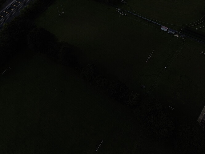

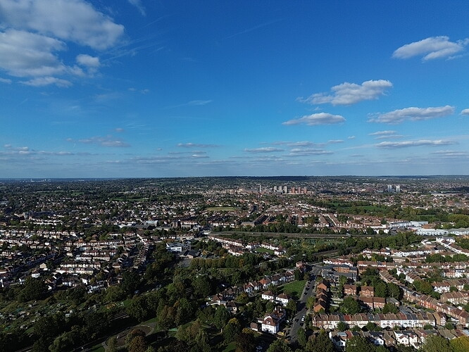

Somethings looks odd, as I too have a Mini 3 and here are some shots I have taken and the exposure seems to be set per shot:
The first with the sky the land part is dark, but the second with mostly land is exposed correctly.

Those are not 360 pano pics, though, and this is where the OP is having the problem.

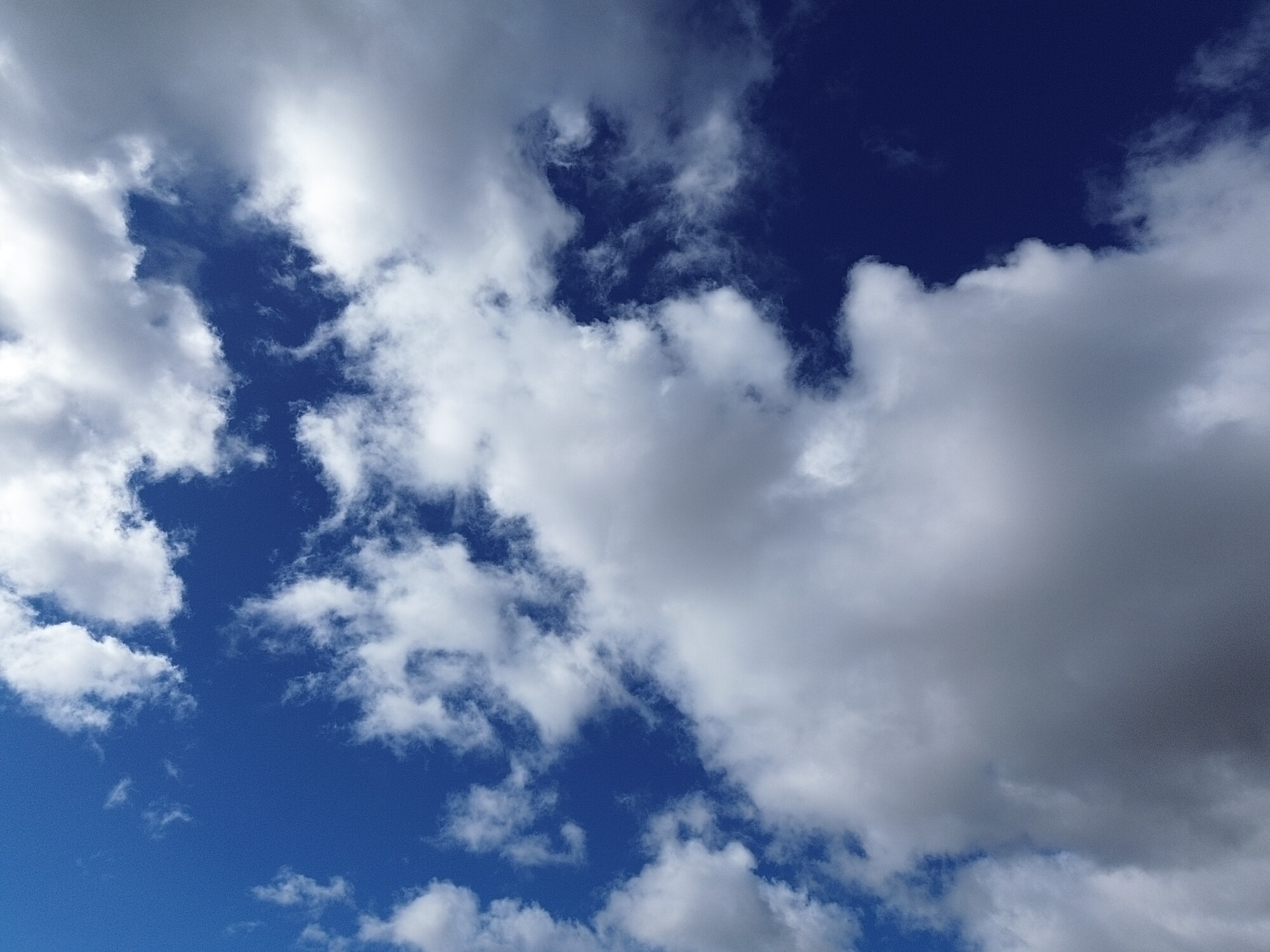

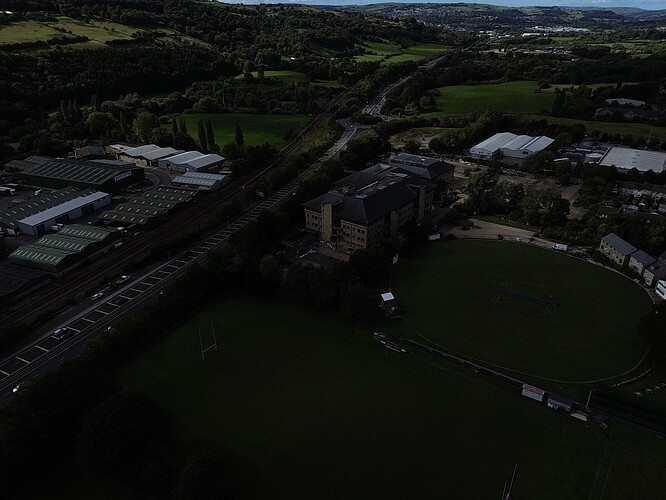

So that’s another sequence of photos it took
They are taken as part of a panorama, in this case a wide-angle (3x3). The key point is that the exposure changes by shot.

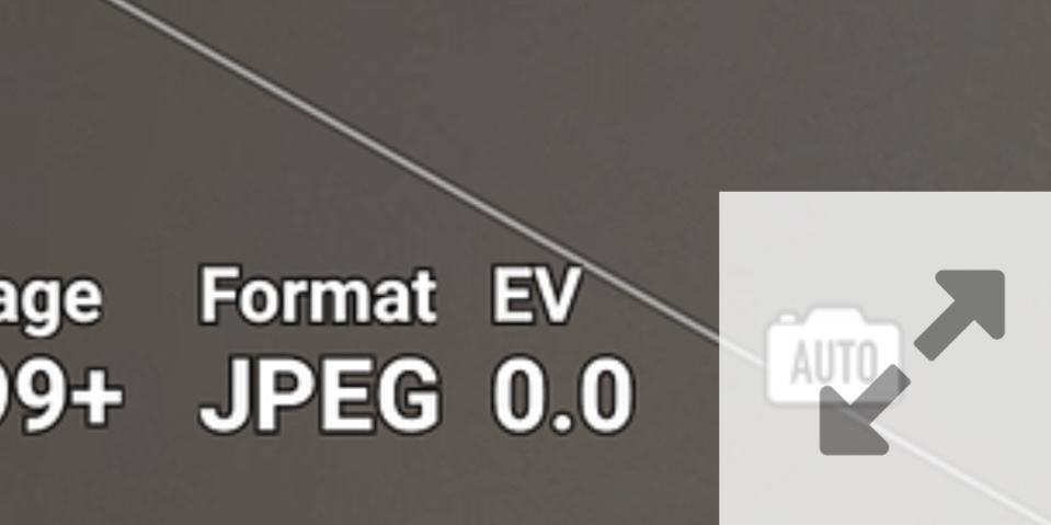

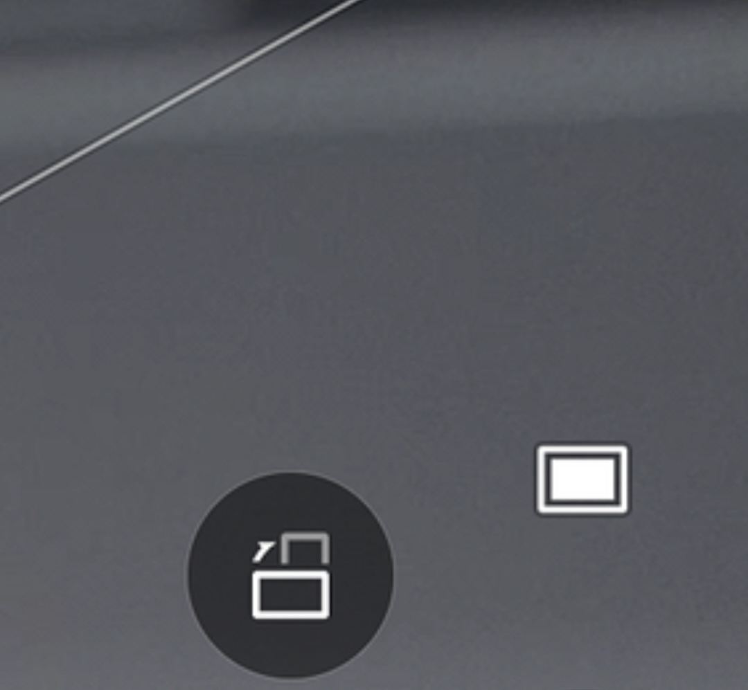

Click on the bit at the bottom where it says jpeg format - go into the settings & see what the iso is saying just a thought,
Also the screen shot is showing a single image not 360 sphere & if memory serves ( with my DJI drone ) although not a mini 3 pro - when you flick it in to panoramas it changes the settings ( even tho ) your settings was fine for a single or hdr if that makes sense which has caught myself out before so worth a look .
Ahhh good point i will have a look at this now before i give it a reset, interesting

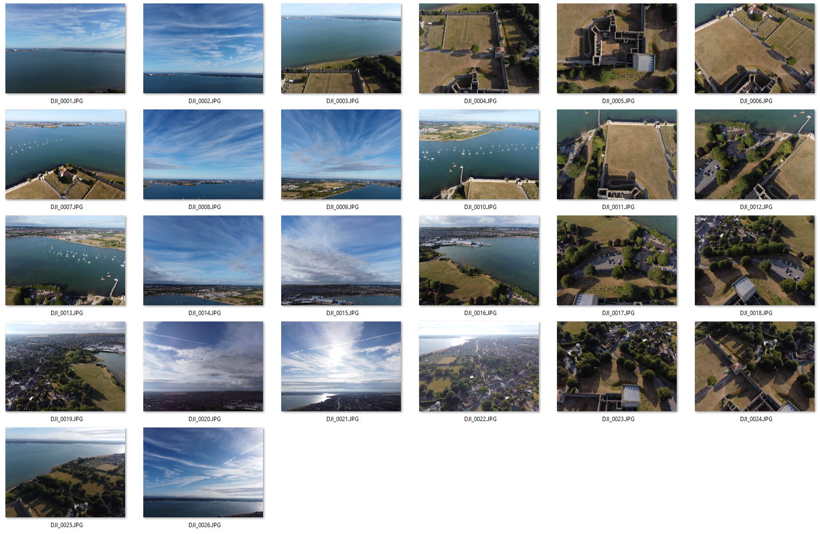

As a guide, my older, and less capable, Mini 2 creates a set of images that vary very little from one another ..
Actually, I’d suggest they are ALL slightly underexposed .. perhaps by half a stop from ideal - but that’s not really the issue, here, or much of a problem. Also, the Mini 2 doesn’t capture .dng that enables retrieval of the shadows so well.

It seems thou your have it in auto and AF that the autofocus is locked.
Have you tap the AF and adjust to test different settings.
before taken a picture tap the center of screen see if it’s locked :locked: if unlocked you have another slider when tapping test adjust.
