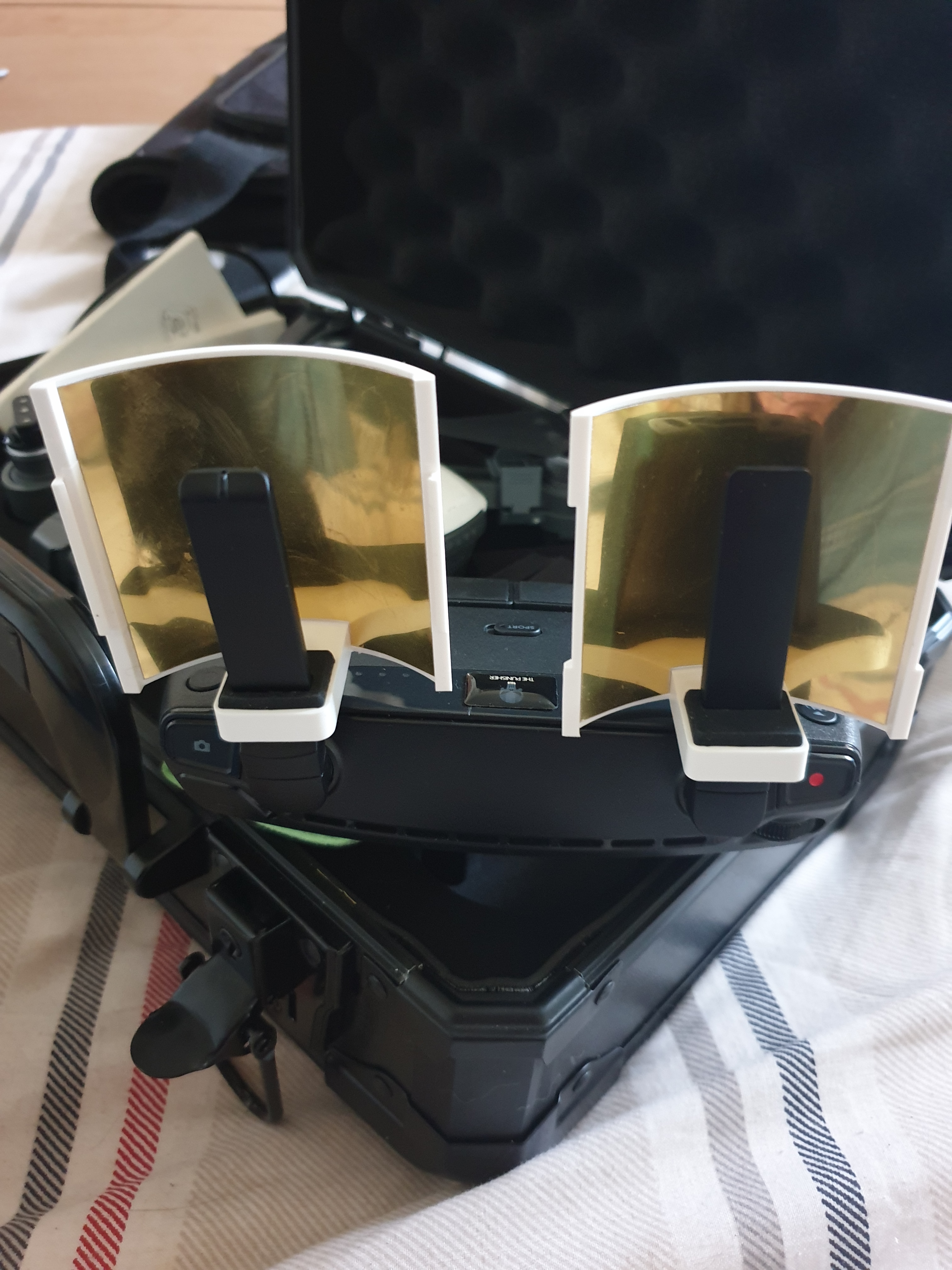

well my drone finally arrived turns out it wasn’t damaged ups lost it anyway all good now set it up played about with it in the back garden just to get a ideal what it’s like. going for a proper flight this afternoon I bought it used and it came with a load of accessories one of them is called a range extender it fits over the antennas made by a company called hensych is it a gimmick or do they actually work.
I’m no expert I tried them last year if anything ( only for me ) can’t comment on anyone else’s experience made my signal worse , I think there rubbish , just my opinion
No.
Search on here for the word “parabolic” and you’ll find plenty of posts and videos.
If range becomes a problem, invest in a proper power amplified antenna setup or go the easier / cheaper route and use software mods to enable FCC mode (also search here, hundreds on threads on the subject).
Glad your drone arrived safely in the end :slight_smile:
Worse than that they’re liable to increase the SWR of the transmitter, reducing the power actually transmitted and reflecting more of it back, shortening the lifespan of the control unit.
File under general ebay tat.
Yes they do work … but as parabolic antennas are ‘reflectors’, make sure you are always facing your drone as, if the drone goes behind you, it will reduce the signal from the drone.
Yagi antennas will also increase the signal (2.4Ghz for UK users) … though I do have some questions myself which I intend to put forward to members.
Please add them to one of the existing threads that we have on yagi antennas already :smiley:
