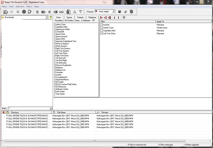

Dave… I think this bulk renamer tool might be the solution
With just a few clicks I’m able to rename an entire folder full of files with a custom date formate (I’m a huge fan of YYYYMMDDHHMMSS) and still keep the original DJI filename on the end:
I have been using a program for PC called “Magic File Renamer”
it will alter virtually any file extension, and/or its name, to your liking, and you can tweak it around to add more or less anything into the name, and keep sequential numbers.
Would not be without it !!.
You can add name/number at the beginning, or at the end, the choice is unlimited.
it will rename more or less any wording or numbering of any file I have tried, or its main title/name.
