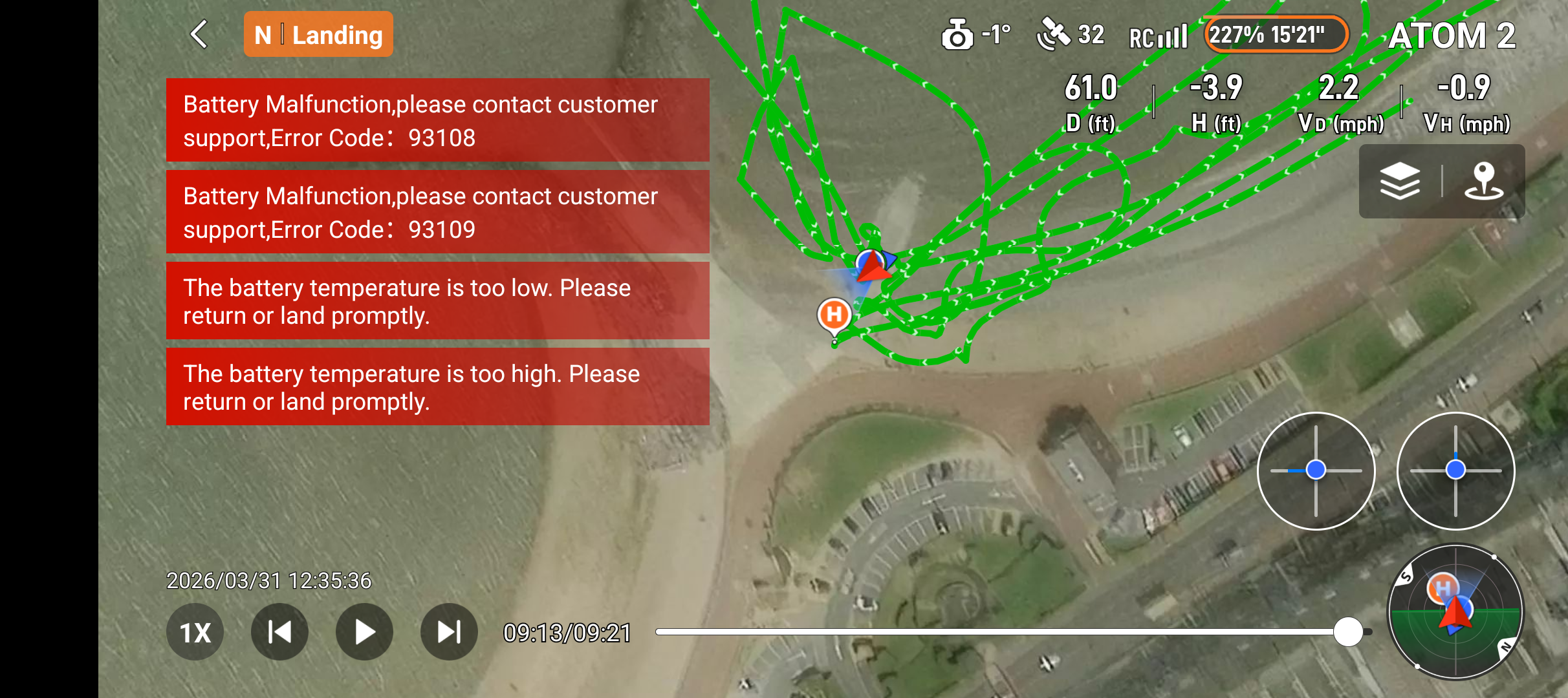

Flew 3 batteries today, one before the problem battery and one after. Temperature 8C according to a weather forecast, bit windy but no wind warnings.
Brought it back and as it was near, the messages flashed up on screen for no more than a second, got this screenshot from the flight replay. It landed straight away, no problems with that.
Battery too cold and battery too hot at the same time and battery capacity was 227% while the messages were on screen.
When the errors disappeared, the battery went back to 58%.
Any Atom 2 owners seen this?

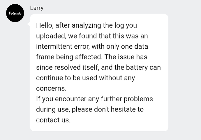

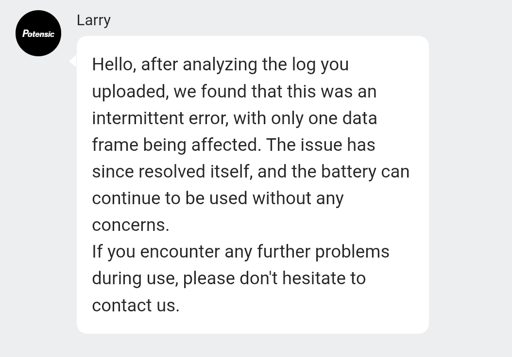

It’s logged with Potensic and flight log uploaded.
Intermittent error, keep on flying. That battery won’t be flown out of sight, over water or over anywhere a landing would be a problem until it earns my trust.
