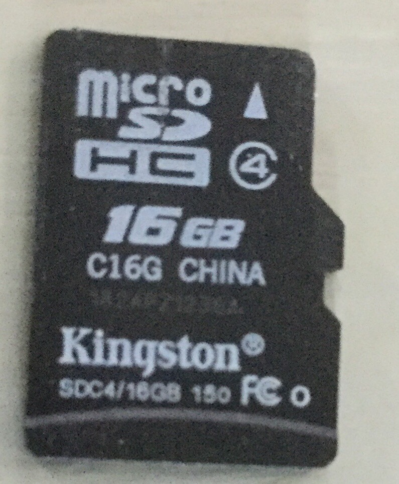

Anyone had problems recording to their SD card.
My Hubsan 501s sometimes records & other times not.
Card clean / freshly formatted / fully fixed in.
Any advice?

I have been using 2 different micro cards.
One a few years old 32Gb & one brand new 16Gb.
I’ll try again tomorrow, formatting them both again in the drone.

John, what resolution is the drone recording in?.
If its a high resolution, then you need a fast card, using old cards that are not fast enough could be the problem.
I always use Sandisk Extreme, never had a problem.
Found this, might be of help.
Unable to copy and paste it so here is the link.
Key points are that your SD card should be 64GB or under, speed class 4 upwards and formatted exfat.
It also mentions you need to check allocation unit size is set to 32KB and volume label must be left blank.

Just checked, it is 1080p HD.

Thought I had formatted in the drone but hadn’t.
Sorry!
Now can’t find any way to format in the menu.
Tried the formatting in the computer under ex fat32, with 32kb but no joy.
Might need to buy a better card!

Put the SD card in right slot on the drone, and mostly does not record.
Got a few pics/vids but nothing after that.
Tried reformatting under ex fat32 but nothing.
Maybe rubbish card
I’ll get a better one on Monday.
