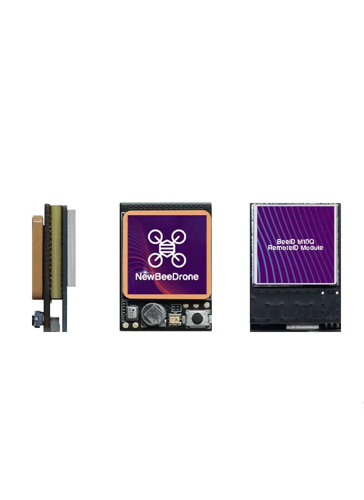

Remote ID - included in a GPS receiver!
Just seen this one (was not really looking into this - not sure how good / reliable / …) – but obviously already available - and not as expensive as what I have heard floated around
£38 plus postage :scream: Scandalous.
I have 6x quads that will need it, so that’s the best part of £240 :scream::scream:
To add insult to injury, 4x already have GPS installed.
As long as you only fly one quad at the time - you should be able to use a single remote id unit? - with a bit of planning not to make it too taxing to move from quad to quad
There are a few reviews around (Bardwell, Oscar) - unit seems to perform well enough (despite being a ‘mini’ GPS - ie 16mm antenna)
Bardwell noted the connector is not standard though - and the 2 pigtails in the box are low quality so something to look into…
Not much in the sense of alternative as of now it seems - there is a Roku about the same price and a stand alone remote id only from Holybro (likely higher quality - more expensive and bigger though)…
Will wait a bit more to see if anything new comes around - looking at the comment section of the reviews - nobody seems to worry much about it in the US despite being mandatory for 2 years now…

Personally I am holding off on this one because of the connector
The batch Bardwell reviewed came with an unknown connector (not the standard jst one) - and the included pigtails have cheap plastic wires (not silicon)
Trying to solder thin plastic wires is a giant pain in the &^% as by the time you have enough heat in for a good joint the plastic starts to melt and leave the strand naked…
May be possible to de-pin the connector and replace the wires but not a certainty and will require some faffing about.
For comparison you can get a similar GPS unit (without remote id) for less than £15 (HGLRC M100 mini) - or even a better one (its 20mm antenna bigger brother is £15).
