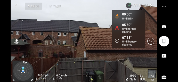

I got it home it just hovered pressed return to home did nothing just stayed there with critical battery warning at 9 % but it’s not on log :thinking:
It won’t do anything on pressing RTH if you are really close to the point that you took off.

How far away from you was it when you pressed RTH?
It seems ok today :thinking:how do you adjust rth battery percentage
Tap the three dots at top-right … and enter the set-up menu. Should be under the battery section.
At 2 feet away it won’t RTH
Not on the Mini 2 , no option to adjust it. 20% brings it home
