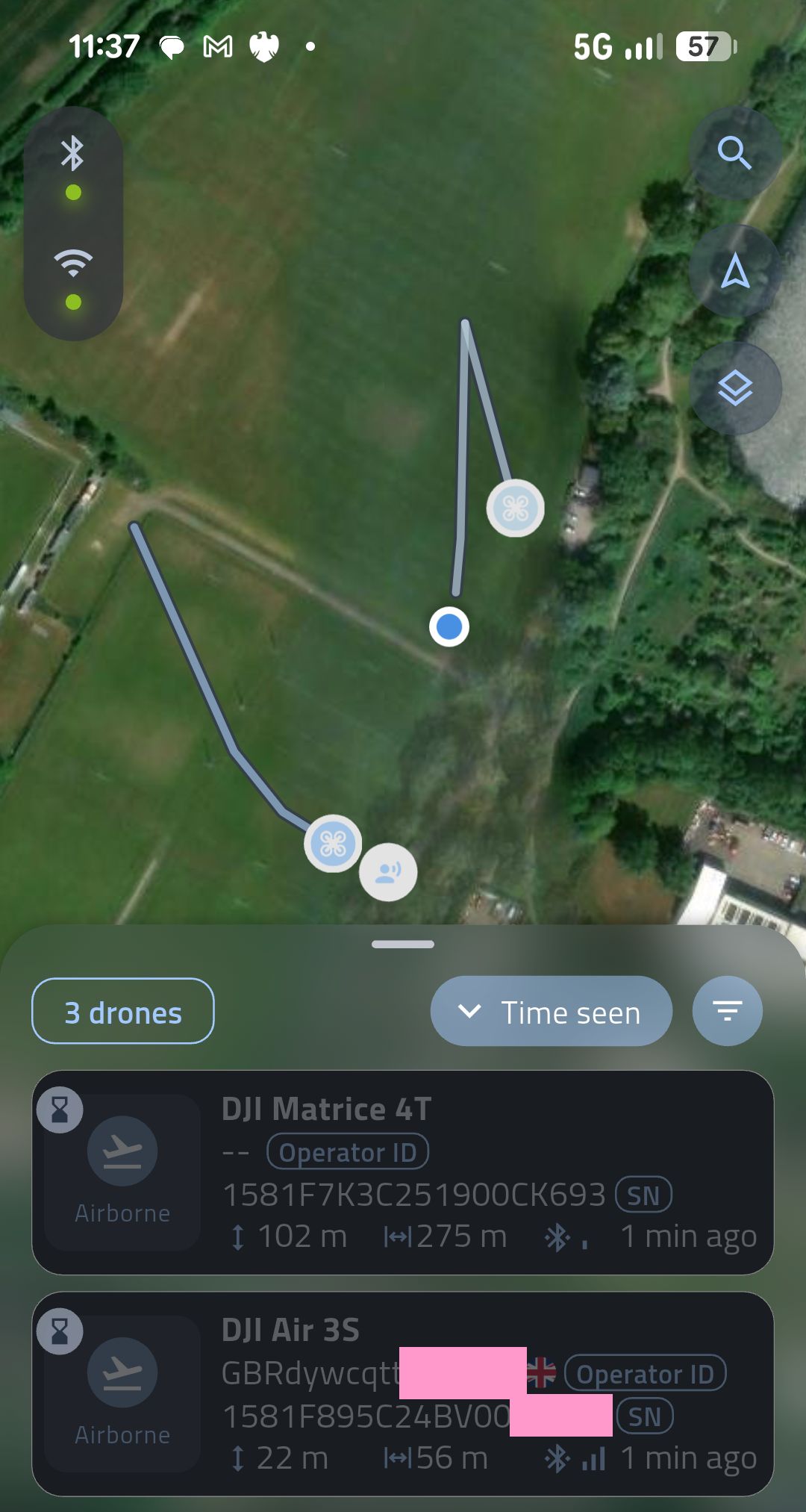

Having established that the RID on my Mini 4 Pro has a range of at least 160 metres from the controller, I decided to try the same experiment with my Air 3S, using DroneScan on my Google pixel 8a phone.
I set up as usual at my sports field test site, downloaded the image of the site for my controller, then turned the WiFi hotspot off so the drone wasn’t competing for the WiFi’s attention.
Sure enough, a drone quickly appeared on the screen. It was only when I did a double-take that I realised it wasn’t my drone. Somebody was flying a Matrice 4T over the other side of the field. This was the first time I had picked up another drone on my DroneScan. It was 275 metres away while my Air 3S was only 56 metres away.
It wasn’t until I got home that I found the Matrice didn’t have an operator ID displayed. It may have been brand new and the owner hadn’t completed the details, or it may have been stolen. FWIW, these are the details from DroneScan:
few questions on the screen shot
1 - are you the blue dot or the little man icon here ? ( guess your the dot and the man is the M4T operator)
2- distance of 275m - is that from you or the distance that the drone flew from the operator ?

The Matrice 4T doesn’t have a requirement to broadcast Remote ID until 2028, it’s all still legal at the moment.
The only requirement today is to have an Operator ID label stuck on it :slight_smile:
I’m the blue dot.
Not sure about the distance. Measuring from Google Earth’s ruler, drone to me is 152 metres, and drone to Mr M4T is 179 metres. With an interval between data bursts of about a minute, the data is old and of unknown accuracy.

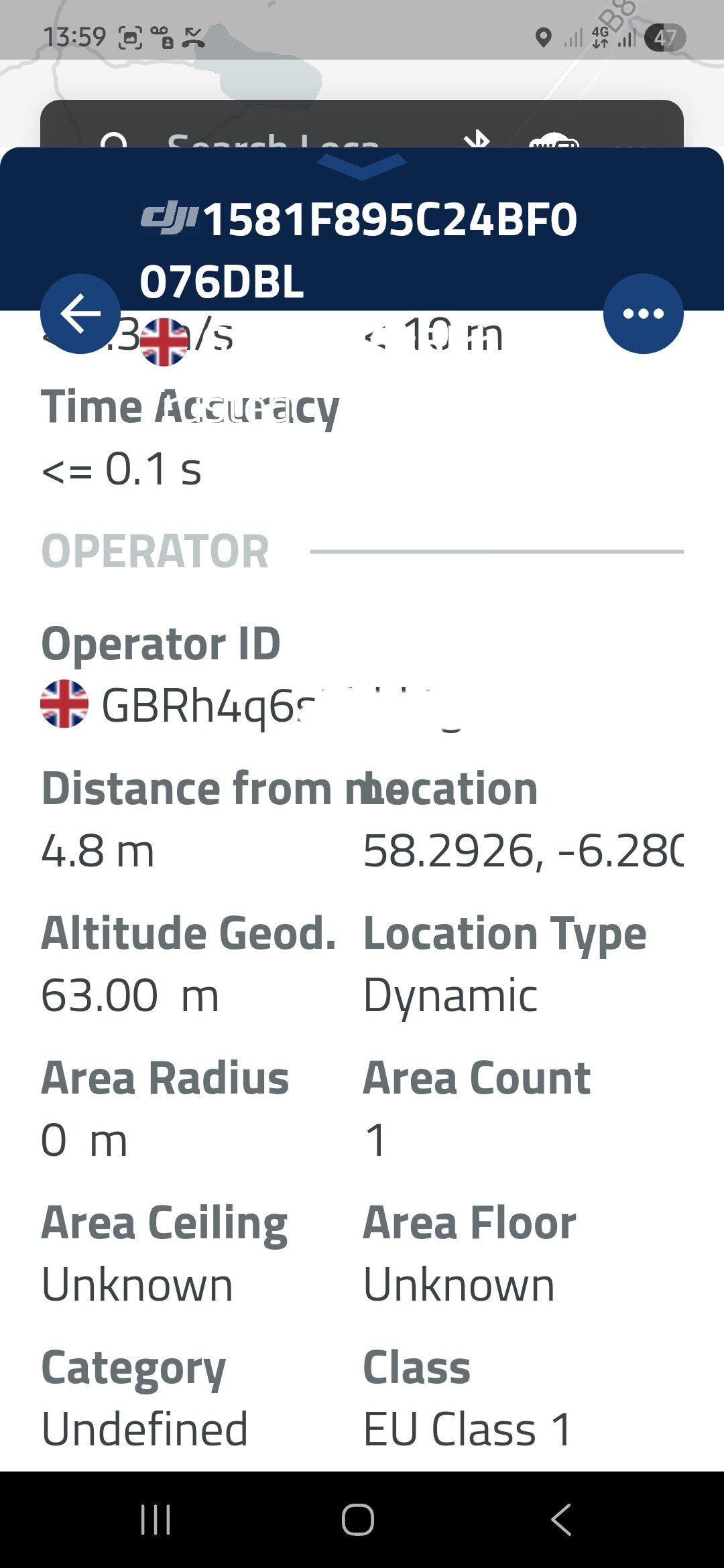

I can’t seem to pick my Air 3S up using the Drone Scanner App. :person_shrugging:

Maybe its your drone scanner app lol.
