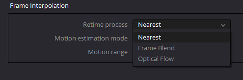

With some more sophisticated editing software programs, rather than just duplicating every frame to create the slower speed, they have the ability to “create” frames that are a mix of the two each side. These certainly minimise the jittery nature of just slowing it down.
Davinci Resolve, for instance, has (amongst a couple of other settings) two versions of frame interpolation, other than just replicating the “nearest”.
Screenshot 2020-10-14 15.21.46
Both increase the rendering time … optical flow quite significantly, but it does achieve a quite acceptable result.
