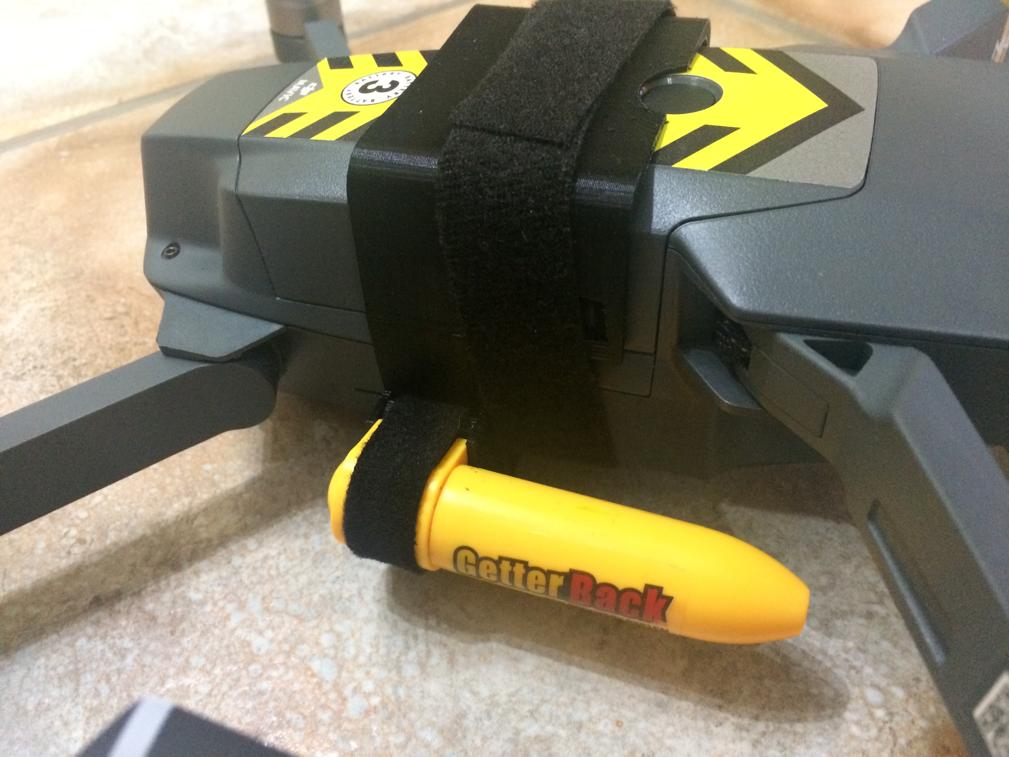

So all that remained was to fit the Getterbacks and mount the whole assembly to the Mavic.
Here’s a few pics of the GBs fitted:
Taking shape!
The velcro on the GBs is quite long, but the hole on the mount is only large enough to get one “wrap” through it. Let’s hope that’s strong enough eh? I trimmed off the excess velcro.

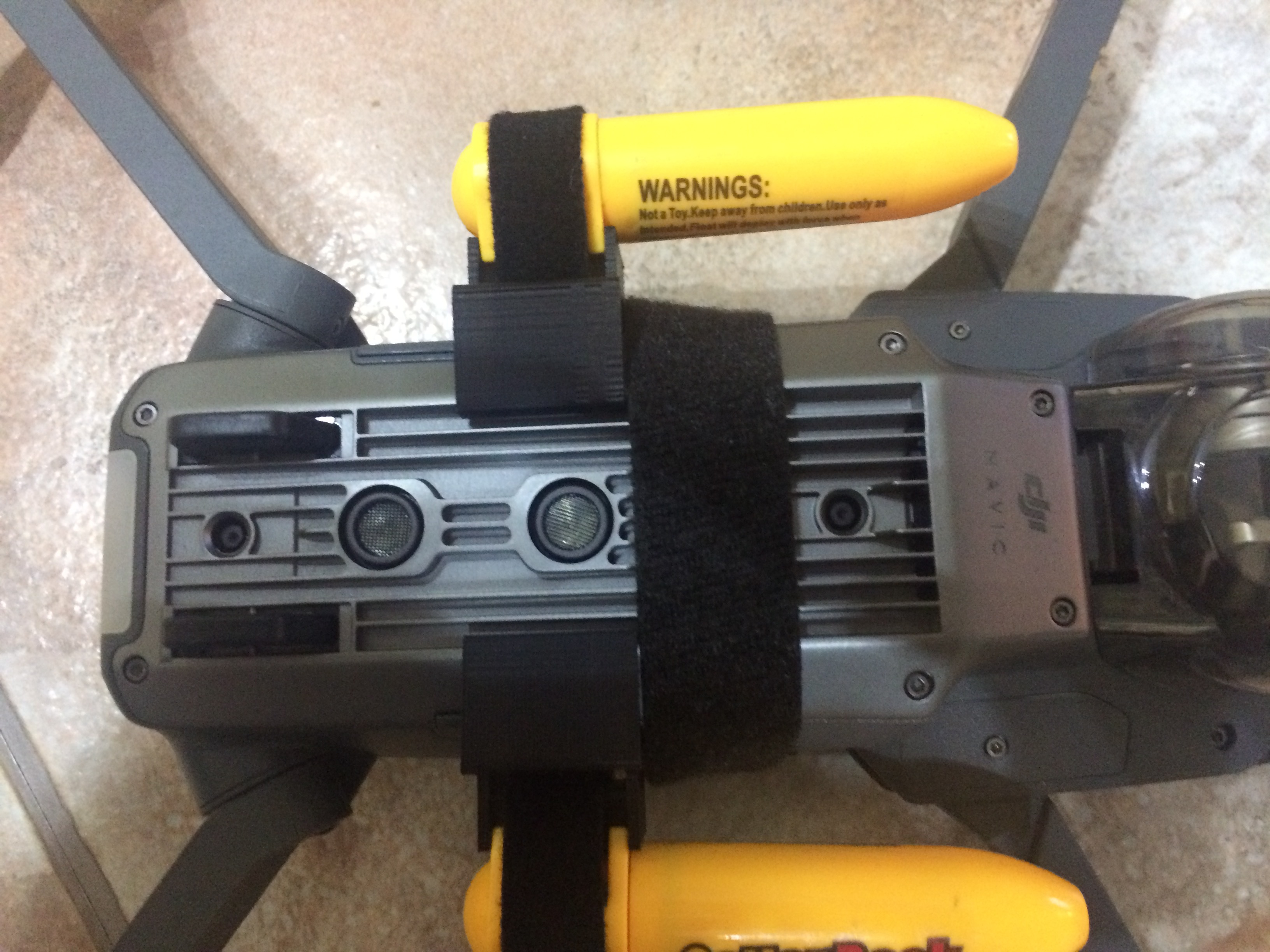

Next step, simply clip the entire assembly over the Mavic Pro:
And the view from the underside, showing the clips locked in to the heatsink fins:
Ok…
So it all looks good. In principal.
In practice, I was getting a little edgy…
If the worst happens, and the Mavic sinks, the Getterbacks would deploy and float to the top of the water. The idea then being that you pull up on the cord(s).
However, if I pull on one of the GBs mounted on the sides, the bracket itself flexes a little. I’m not sure how much of an issue this is, or might be, but I suspect that with enough force (such as yanking it up from the bottom of a canal), the bracket could possibly unclip itself from the heatsink.
So, to prevent this and in order to add yet another layer of protection, I decided to wrap a velcro strap around the whole shebang:
NOW FALL OFF!!!

Since the base of the Mavic is a massive heat sink does strapping this bracket across it cause any problems?
It “should” be ok…
The clip itself only latches on to the side of the heatsink so no issues there. The additional velcro strap is only 25mm or so wide and the air can still flow under that. I don’t think heat will be an issue :slight_smile:
